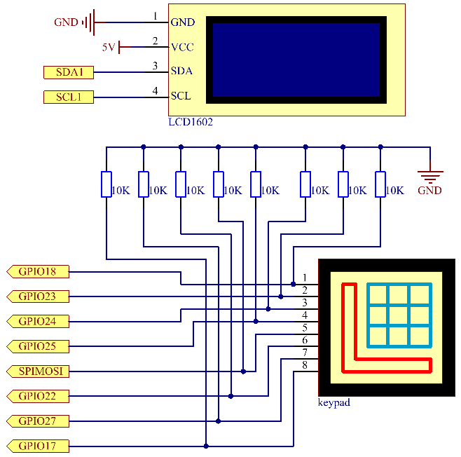

Schematic Diagram
T-Board Name
physical
wiringPi
GPIO18
Pin 12
18
GPIO23
Pin 16
23
GPIO24
Pin 18
24
GPIO25
Pin 22
25
SPIMOSI
Pin 19
12
10
GPIO22
Pin 15
22
GPIO27
Pin 13
27
GPIO17
Pin 11
0
17
SDA1
Pin 3
SDA1(8)
SDA1(2)
SCL1
Pin 5
SCL1(9)
SDA1(3)
../_images/Schematic_three_one121.png

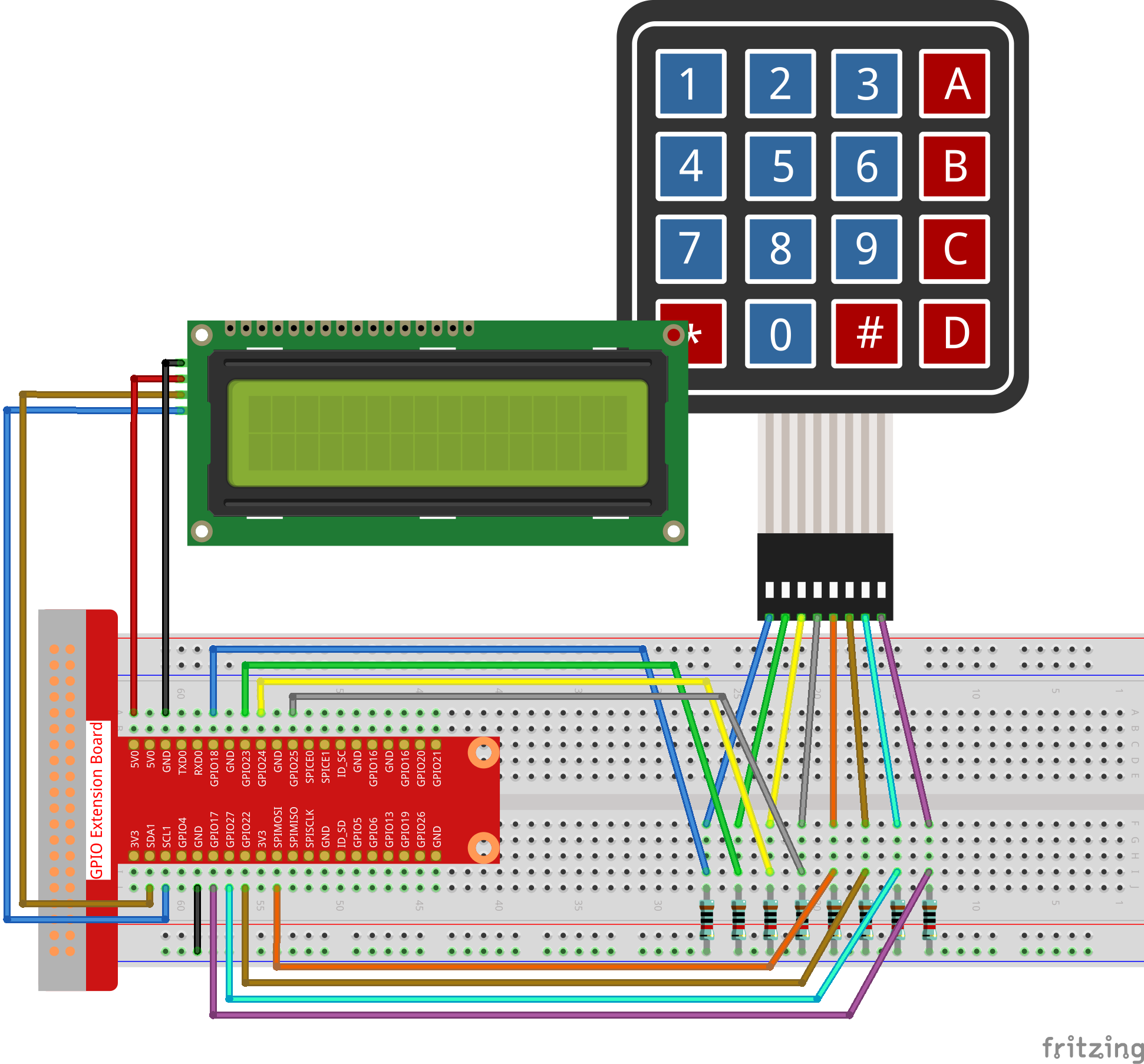

Experimental Procedures
Step 1: Build the circuit.
../_images/image2731.png
Step 2: Setup I2C (see Appendix. If you have set I2C, skip this step.)
Step 3: Change directory.
cd ~/davinci-kit-for-raspberry-pi/c/3.1.12/
Step 4: Compile.
gcc 3.1.12_GAME_GuessNumber.c -lwiringPi
Step 5: Run.
sudo ./a.out
