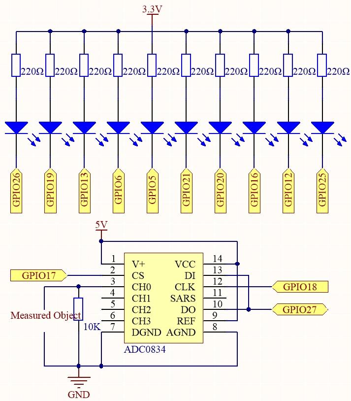

Schematic Diagram

../_images/Schematic_three_one51.png
