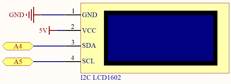

Schéma
../_images/circuit_7.1_lcd1602.png
