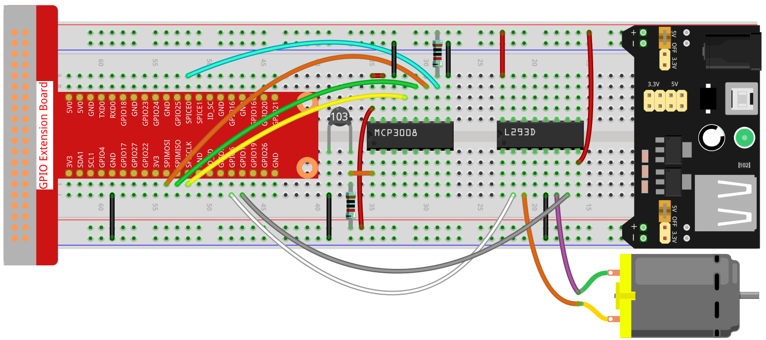

1. Cablaggio
../../_images/3.1.4_smart_fan_iot.png
