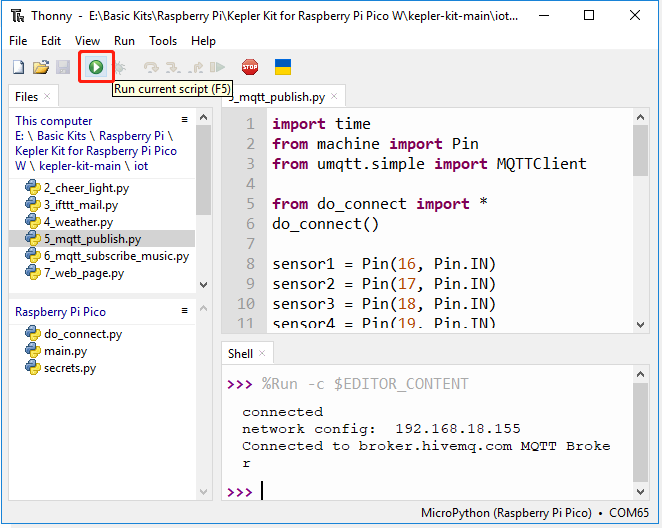

5. Run the Script
  1. Open the 8.5_mqtt_publish.py file under the path of pico-2w-kit-main/micropython/iot.
  2. Click the Run current script button or press F5 to run it.
    ../../_images/5_calling_system2.png
  3. Go back to HiveMQ Web Client again and when you press one of the buttons on the breadboard, you will be able to see the Messages prompt on HiveMQ.
    ../../_images/mqtt-4.png
