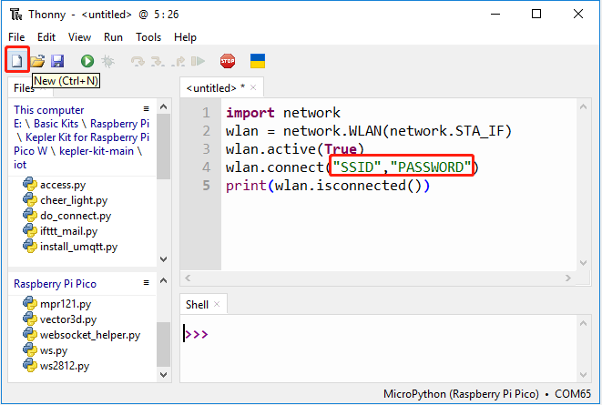

  1. Create a new script by clicking the New button on Thonny, and copy and paste the above code, changing the SSID and PASSWORD to your own.

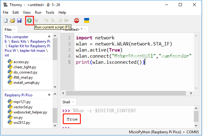

  2. To run the script, click the Run current script button or press F5. If the connection is successful, true will be printed.
    Make sure the Raspberry Pi Pico 2 W is connected to computer via a USB cable, then click on the bottom right corner to select MicroPython (Raspberry Pi Pico).COMXxx as the interpreter.

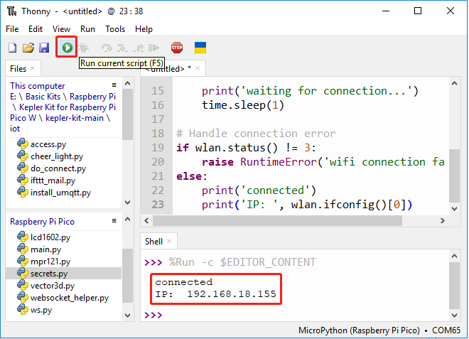

Considering some poor network conditions, let’s add some timeout judgment to the code.
If the connection is successful, the IP of Pico 2 W will be displayed after copying and running the script.

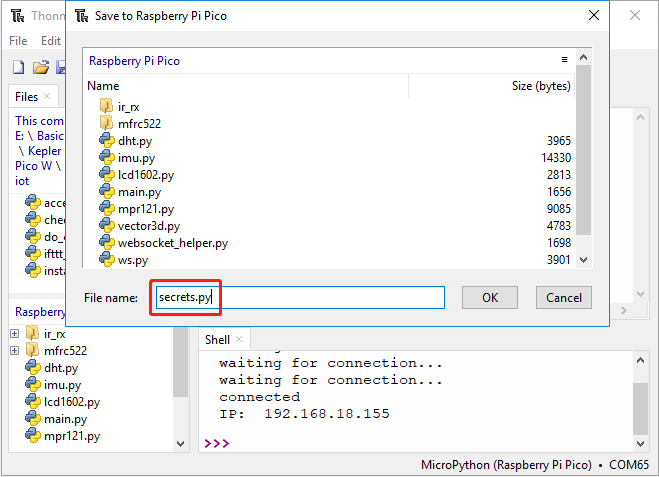

  2. Choose Raspberry Pi Pico in the pop-up window that appears when you click the Save button or press Ctrl+S.

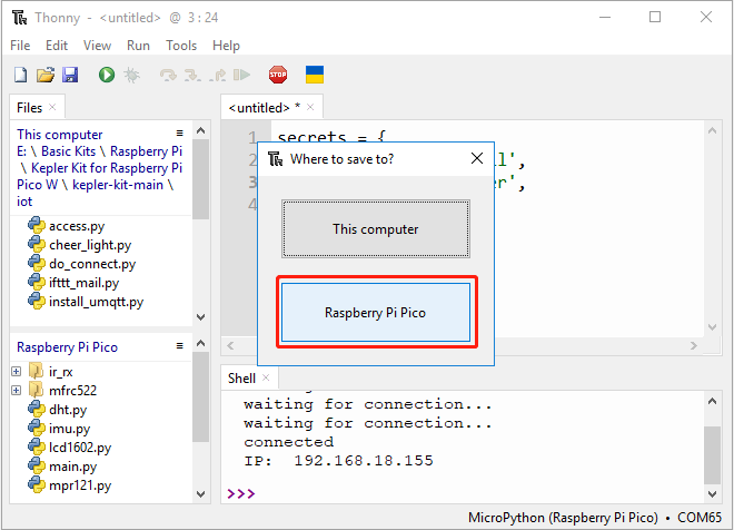

    ../../_images/access4.png
  3. Set the name to secrets.py.
