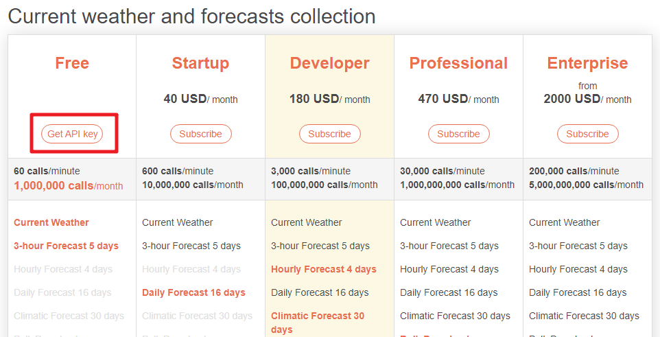

  4. Under Current weather and forecasts collection, subscribe to the appropriate service. In our project, Free is good enough.
    ../../_images/OWM-4.png

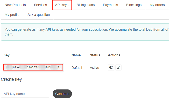

  5. Copy the Key from the API keys page.
    ../../_images/OWM-5.png

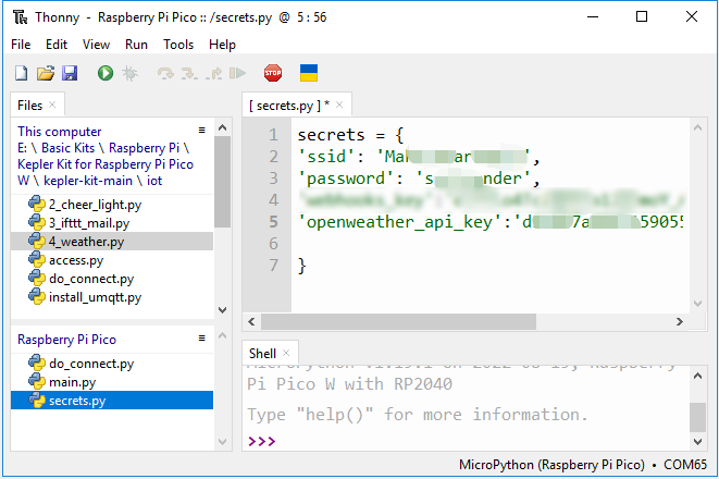

  6. Copy it to the secrets.py script in Raspberry Pi Pico 2 W.
    ../../_images/4_openweather1%281%29.png
    If you don’t have do_connect.py and secrets.py scripts in your Pico 2 W, you need to create them in your Pico 2 W, please refer to 8.1 Access to the Network to create them.

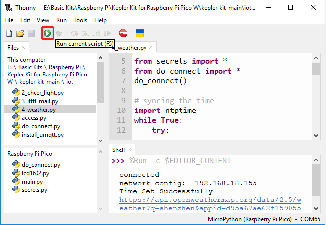

4. Run the Script
  1. Open the 8.4_weather.py file under the path of pico-2w-kit-main/micropython/iot, click the Run current script button or press F5 to run it.
    ../../_images/4_openweather2.png
  2. After the script runs, you will see the time and weather information of your location on the I2C LCD1602.
    When the code is running, if the screen is blank, you can turn the potentiometer on the back of the module to increase the contrast.
  3. If you want this script to be able to boot up, you can save it to the Raspberry Pi Pico 2 W as main.py.
