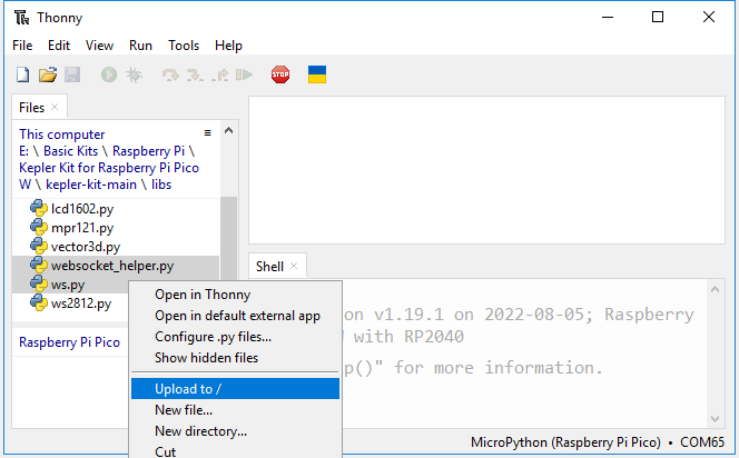

  1. Upload ws.py and websocket_helper.py from the path of pico-2w-kit-main/micropython/libs to the Raspberry Pi Pico 2 W.

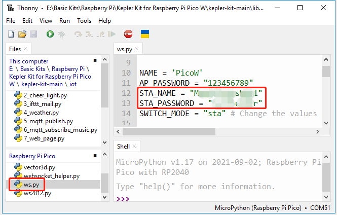

  2. Double click the ws.py script and fill your WiFi’s SSID and PASSWORD.

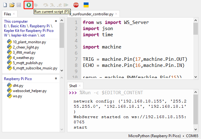

  3. Open the 9_sunfounder_controller.py under the path of pico-2w-kit-main/micropython/iot. Click the Run current script button or press F5 to run it. After successful connection, you will see the IP of Pico 2 W.
    ../../_images/9_sc2.png
    If you want this script to be able to boot up, you can save it to the Raspberry Pi Pico 2 W as main.py.
