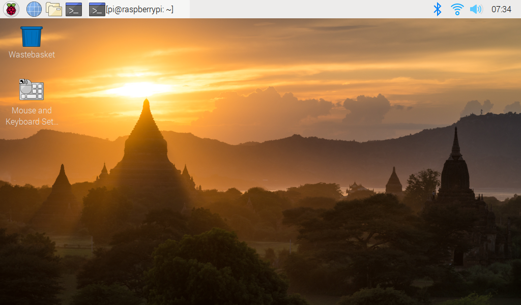

  1. Insert the SD card you’ve set up with Raspberry Pi OS into the micro SD card slot on the underside of your Raspberry Pi.
  2. Plug in the Mouse and Keyboard.
  3. Connect the screen to Raspberry Pi’s HDMI port and make sure your screen is plugged into a wall socket and switched on.
    If you use a Raspberry Pi 4, you need to connect the screen to the HDMI0 (nearest the power in port).
  4. Use the power adapter to power the Raspberry Pi. After a few seconds, the Raspberry Pi OS desktop will be displayed.
    ../../_images/image201.png
