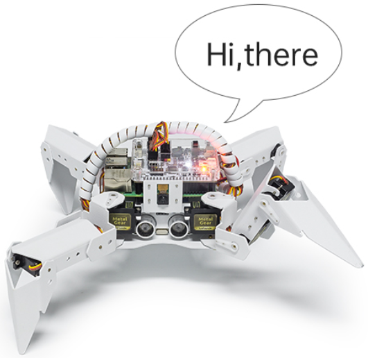

Sound Effect
In this example, we use PiCrawler's (to be precise, Robot HAT's) sound effects. It consists of three parts, namely Muisc, Sound, Text to Speech.
../_images/tts.png
