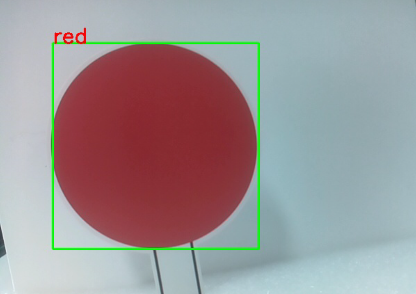

  • Color Detect
    Entering a number between 1~6 will detect one of the colors in "red, orange, yellow, green, blue, purple". Enter 0 to turn off color detection.
    ../_images/DTC2.png
    You can download and print the PDF Color Cards for color detection.

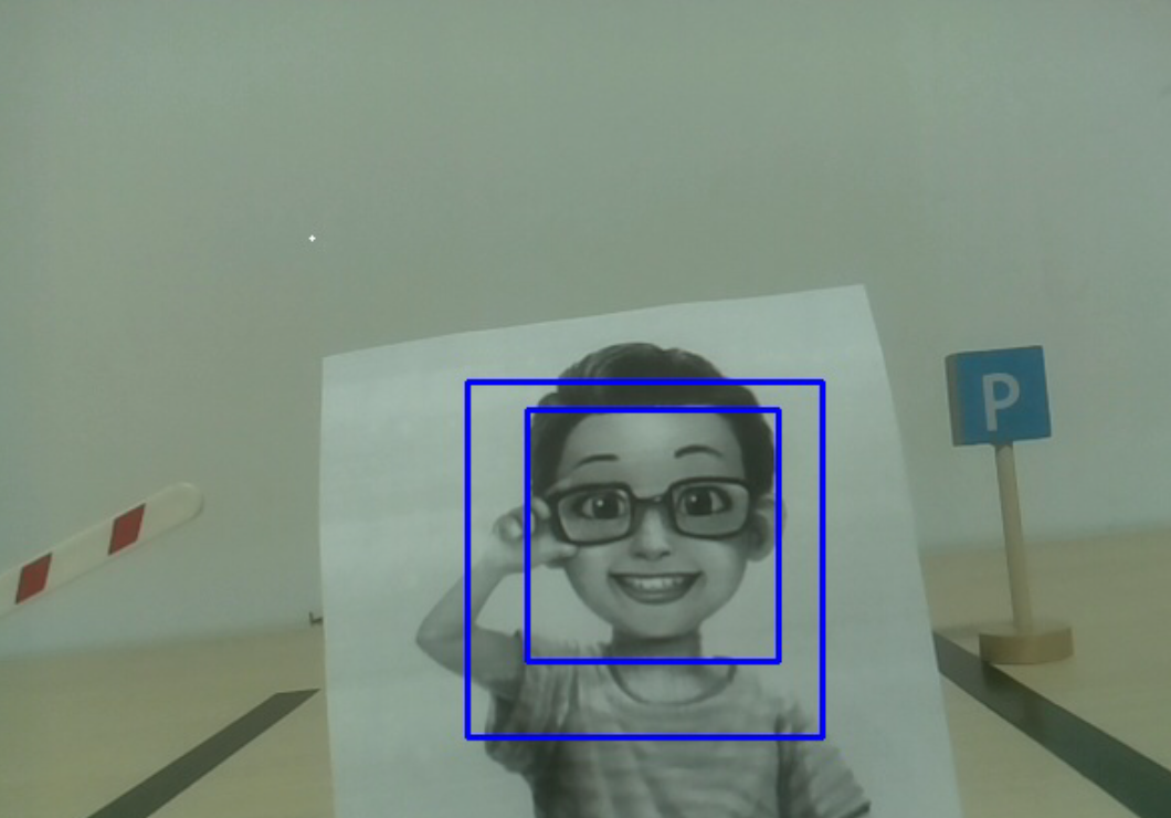

  • Face Detect
    Type f to turn on face detection.
    ../_images/DTC5.png

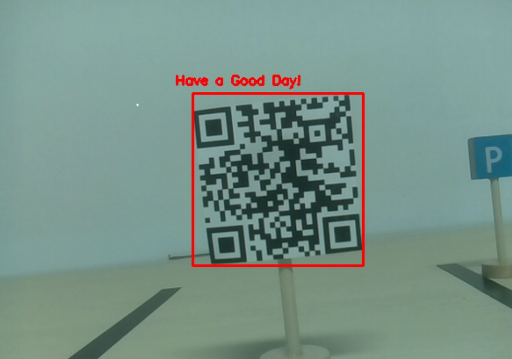

  • QR Code Detect
    Enter r to open the QR code recognition. No other operations can be performed before the QR code is recognized. The decoding information of the QR code will be printed in the terminal.
    ../_images/DTC4.png
