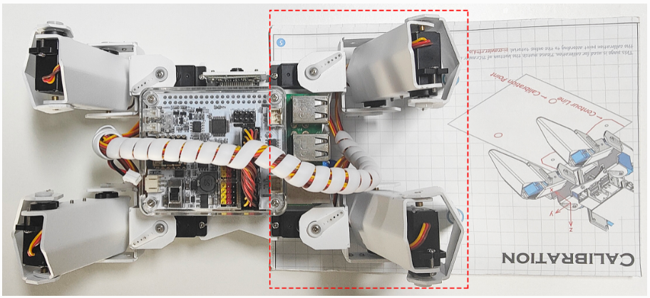

  1. Take out the assembly leaflet, turn it to the last page, and lay it flat on the table. Then place the PiCrawler as shown below, aligning its bottom with the outline on the calibration chart.
    ../../_images/calibration21.png

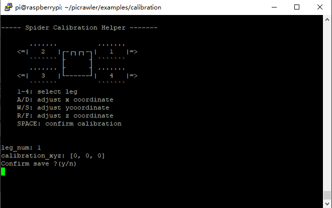

  2. Run the calibration.py.
    cd /home/pi/picrawler/examples/calibration
    sudo python3 calibration.py
    After running the above code, you will see the following interface displayed in the terminal.
    ../../_images/calibration1.png

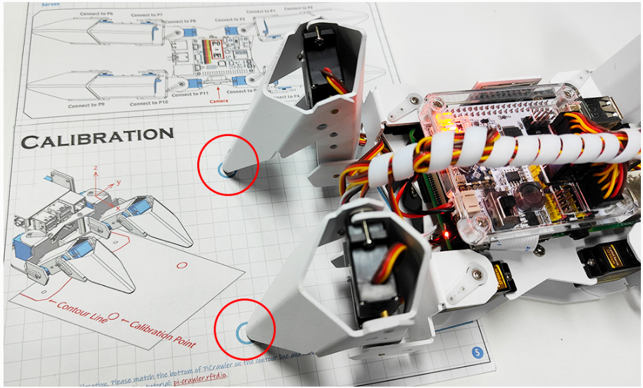

  3. Press 2 and 3 keys respectively to choose left 2 legs,then press w, a, s, d, r, and f keys to move them to the calibration point.
    ../../_images/calibration31.png

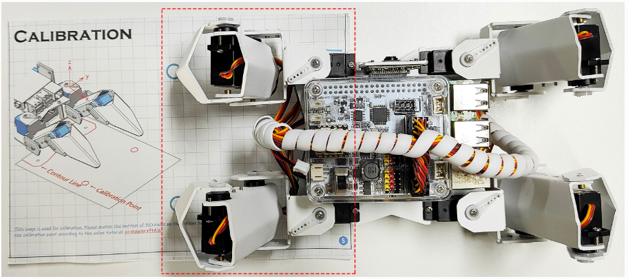

  4. Now, change the calibration paper to the right and press the 1 and 4 keys to choose right 2 legs, then press w, a, s, d, r, and f keys to move them to the calibration point.
    ../../_images/calibration41.png
  5. After the calibration is completed, press the space key to save, you will be prompted to enter Y to confirm, and then ctrl+c to exit the program to complete the calibration.
