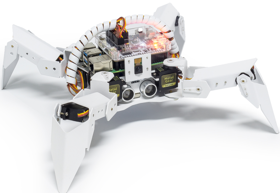

This is PiCrawler's first project. Perform its most basic function - move.
../_images/move.png
Run the Code
cd /home/pi/picrawler/examples
sudo python3 move.py
After the code is executed, PiCrawler will perform the following actions in sequence: move forward, move backward, turn left, turn right, stand.
