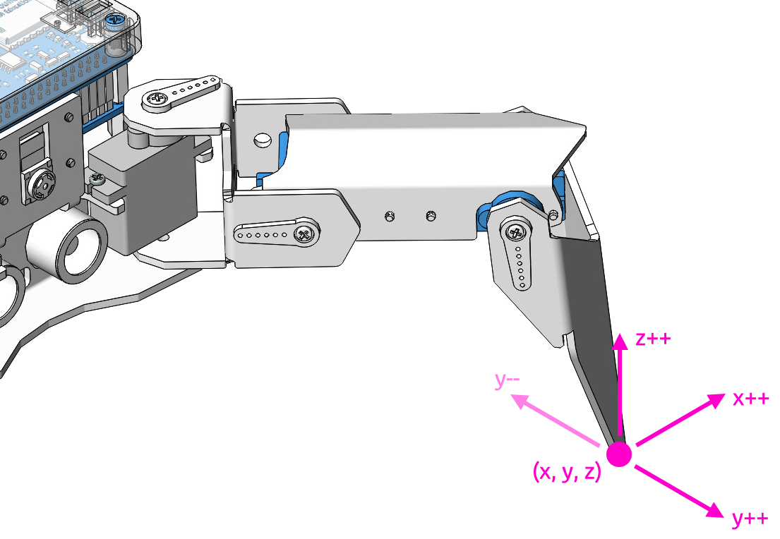

In this example, we use the keyboard to control the PiCrawler foot by foot and assume the desired posture.
You can press the space bar to print out the current coordinate values. These coordinate values come in handy when you create unique actions for PiCrawler.

  • Press 1234 to select the feet separately, 1: right front foot, 2: left front foot, 3: left rear foot, 4: right rear foot
  • Press w, a, s, d, r, and f to slowly control the PiCrawler's coordinate values.
  • Press space to print all coordinate values.
