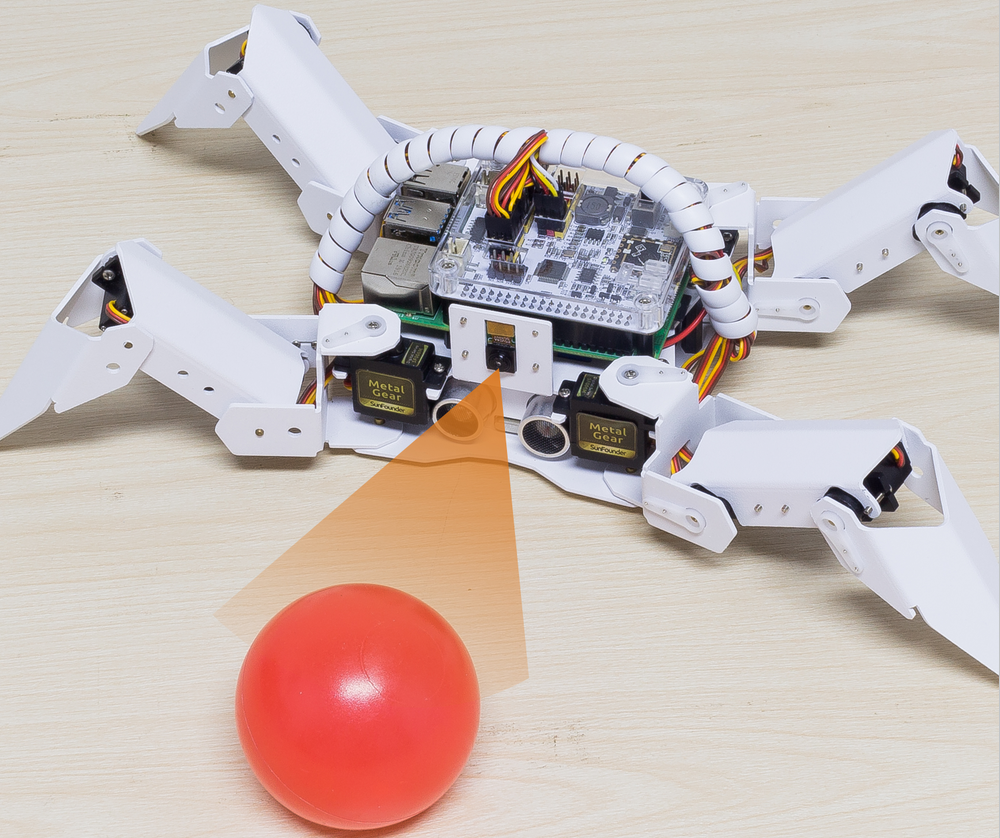

Bull Fight
Make PiCrawler an angry bull! Use its camera to track and rush the red cloth!

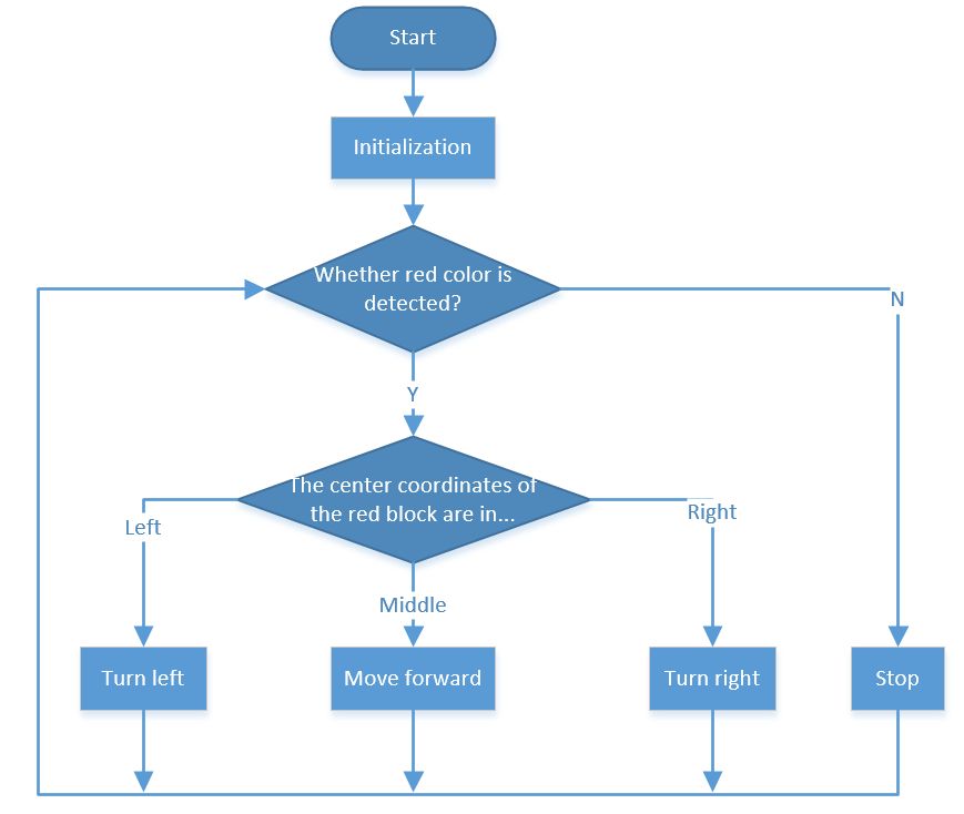

How it works?
In general, this project combines the knowledge points of Move, Computer Vision and Sound Effect.
Its flow is shown in the figure below:
../_images/bull_fight-f.png
