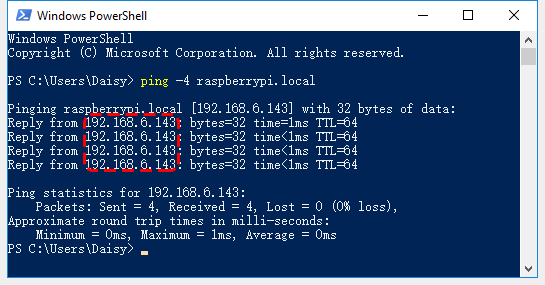

  2. Then, check the IP address of your Raspberry Pi by typing in ping -4 <hostname>.local.
    ping -4 raspberrypi.local
    ../../_images/sp221221_145225.png
    As shown above, you can see the Raspberry Pi's IP address after it has been connected to the network.

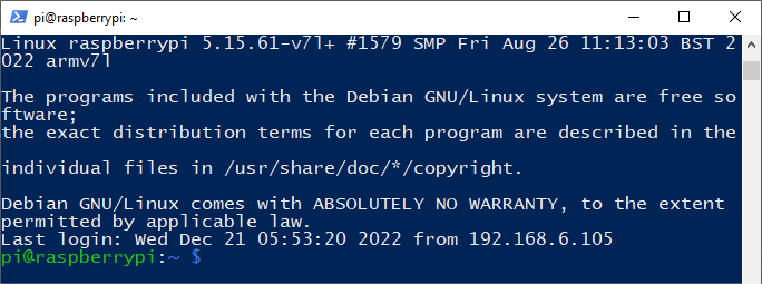

  5. Input the password you set before. (Mine is raspberry.)
    When you input the password, the characters do not display on window accordingly, which is normal. What you need is to input the correct password.
  6. We now get the Raspberry Pi connected and are ready to go to the next step.
    ../../_images/sp221221_140628.png

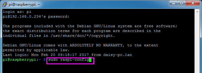

  1. Input the following command:
    sudo raspi-config

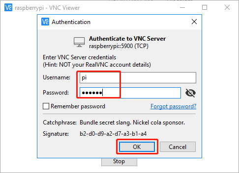

  3. After entering your Raspberry Pi name and password, click OK.
    ../../_images/vnc_viewer2.png

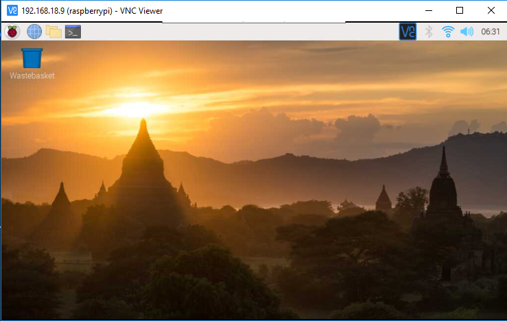

  4. Now you can see the desktop of the Raspberry Pi.
    ../../_images/image2941.png
