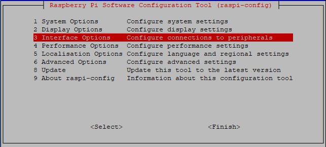

  2. Choose 3 Interfacing Options by press the down arrow key on your keyboard, then press the Enter key.

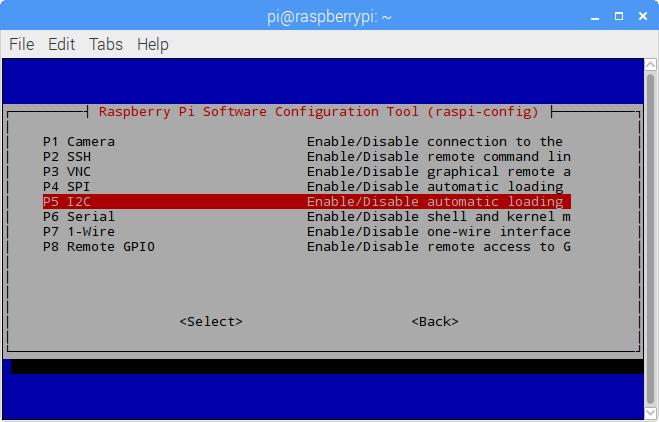

  3. Then P5 I2C.
    ../../_images/image2831.png

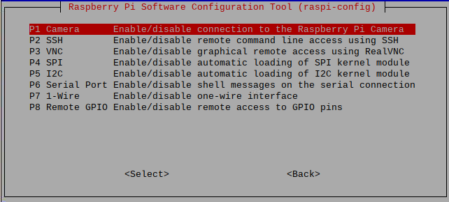

  5. Go to 3 Interfacing Options again and select P1 Camera.
    ../../_images/camera_enable.png
