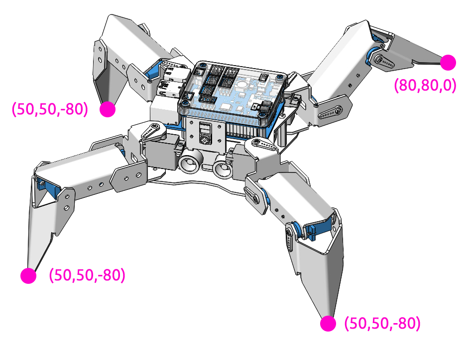

PiCrawler can assume a specific posture by writing a coordinate array. Here it assumes a raised right rear foot posture.
../_images/4cood.A.png

## [right front],[left front],[left rear],[right rear]
new_step=[[50, 50, -80], [50, 50, -80],[80, 80, 0], [50, 50, -80]]

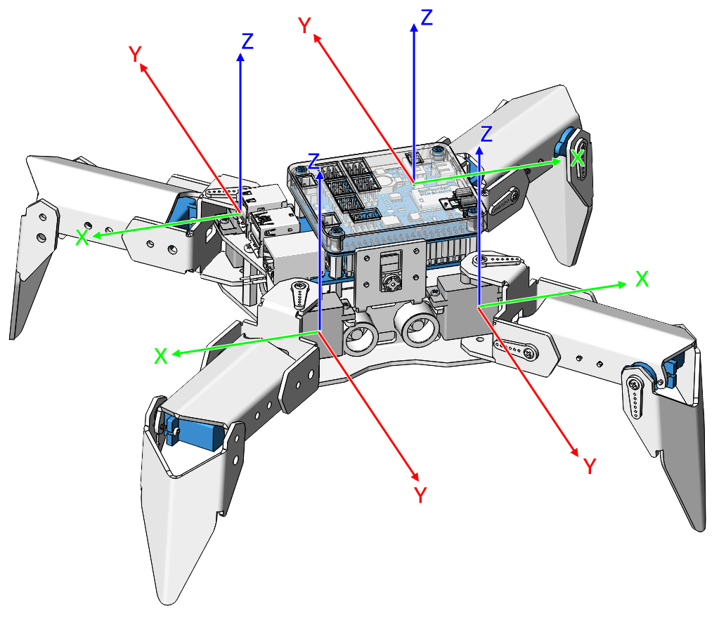

Each foot has an independent coordinate system. As shown below:
../_images/4cood.png

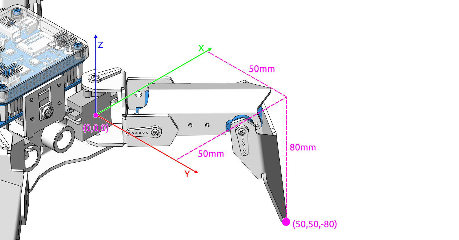

You need to measure the coordinates of each toe individually. As shown below:
../_images/1cood.png
