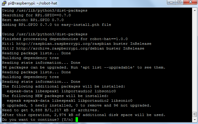

Install robot-hat module.
cd /home/pi/
git clone https://github.com/sunfounder/robot-hat.git
cd robot-hat
sudo python3 setup.py install
Running setup.py will download some necessary components. You may fail to download due to network problems. You may need to download again at this time. In the following cases, enter Y and press Enter.
../../_images/dowload_code.png

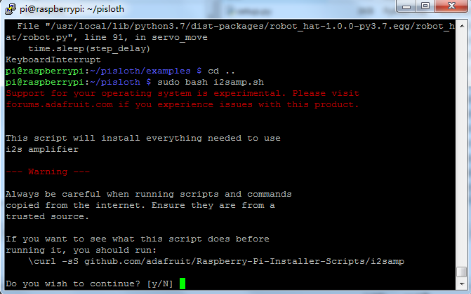

Finally, you need to run the script i2samp.sh to install the components required by the i2s amplifier, otherwise the pislot will have no sound.
cd /home/pi/picrawler
sudo bash i2samp.sh
../../_images/i2s.png

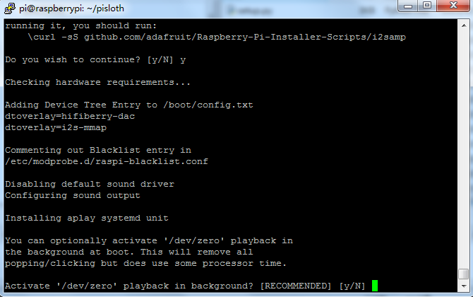

Type y and press Enter to continue running the script.
../../_images/i2s2.png

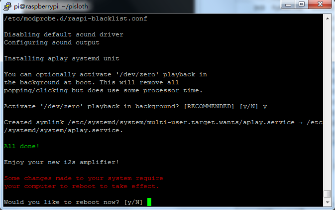

Type y and press Enter to run /dev/zero in the background.
../../_images/i2s3.png
Type y and press Enter to restart the machine.
If there is no sound after restarting, you may need to run the i2samp.sh script multiple times.
