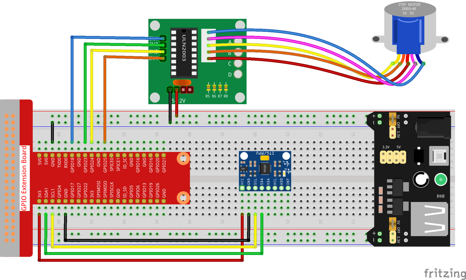

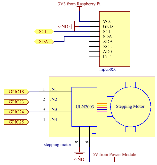

Schema di Collegamento
Pin 16
Pin 18
GPIO25
Pin 22
25
SDA1
Pin 3
SCL1
Pin 5
../_images/Schematic_three_one61.png
