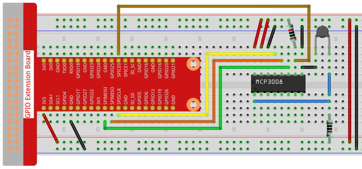

Schema elettrico
Nome T-Board
fisico
WiringPi
SPICE0
pin24
10
8
SPIMOSI
pin19
12
10
SPIMISO
pin21
13
9
SPISCLK
pin23
14
11
_images/schematic_2.2.2_thermistor_mcp3008.png
Procedure sperimentali
_images/july24_2.2.2_thermistor_mcp3008.png
