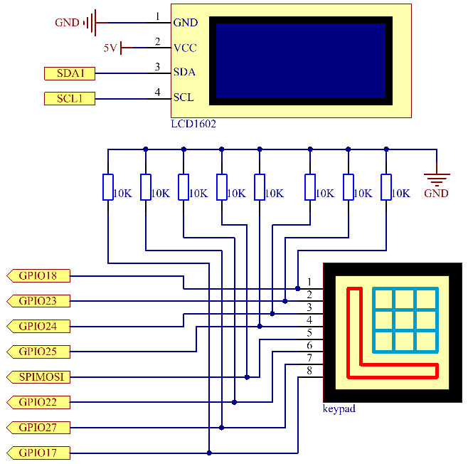

Diagrama de Esquemático
Pin 16
Pin 18
GPIO25
Pin 22
25
Pin 19
SDA1
Pin 3
SDA1(8)
SDA1(2)
SCL1
Pin 5
SCL1(9)
SDA1(3)
../_images/Schematic_three_one121.png

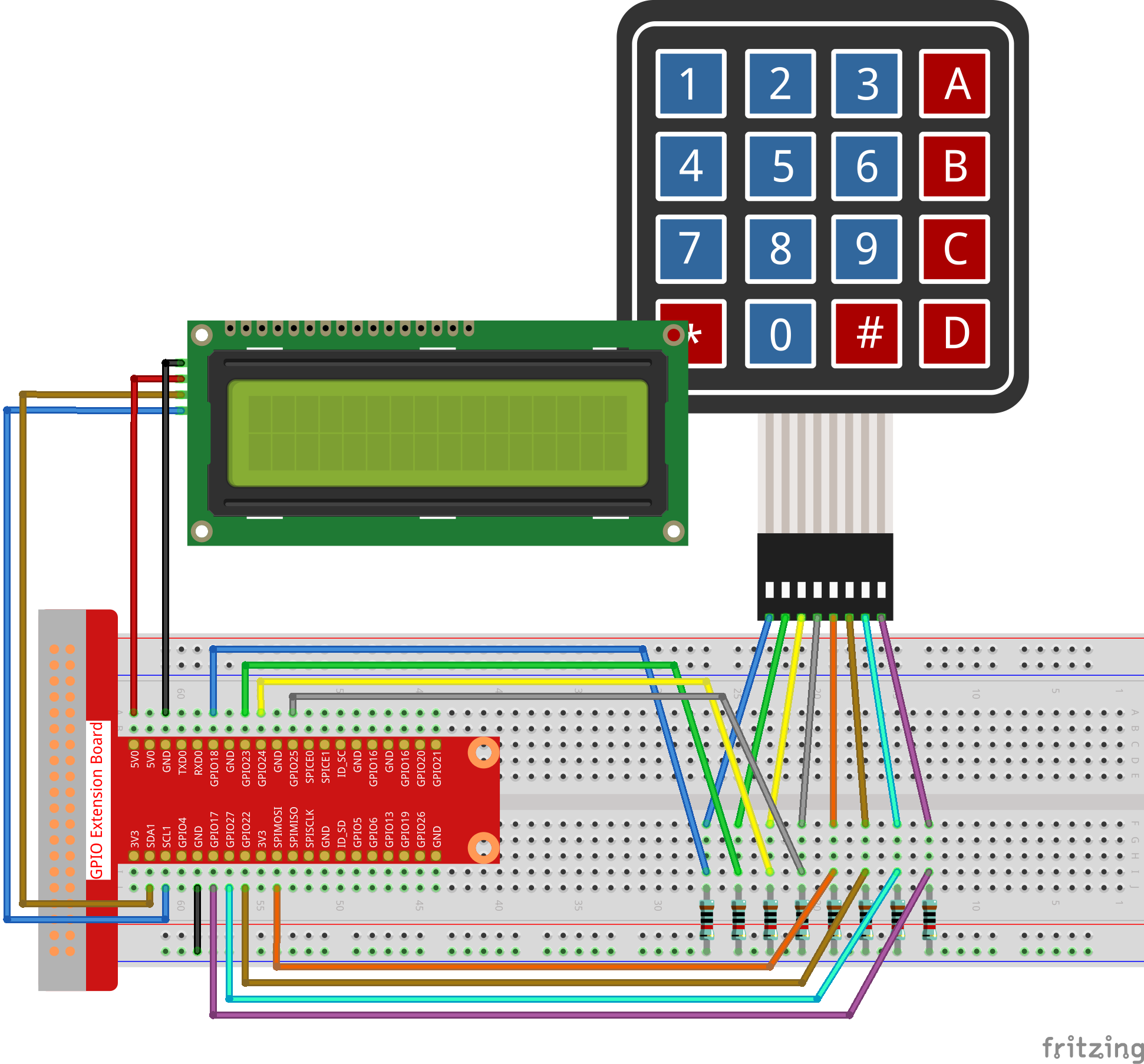

Guess Number_bb
