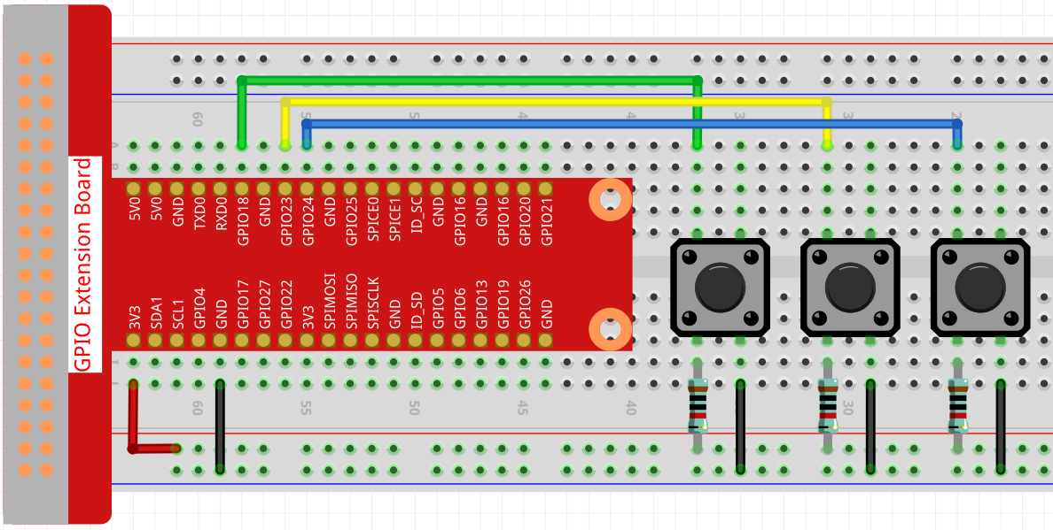

Cablatura
../_images/circuit_dancing_dot.png
