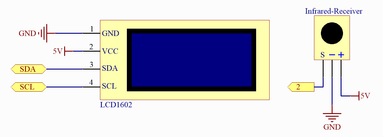

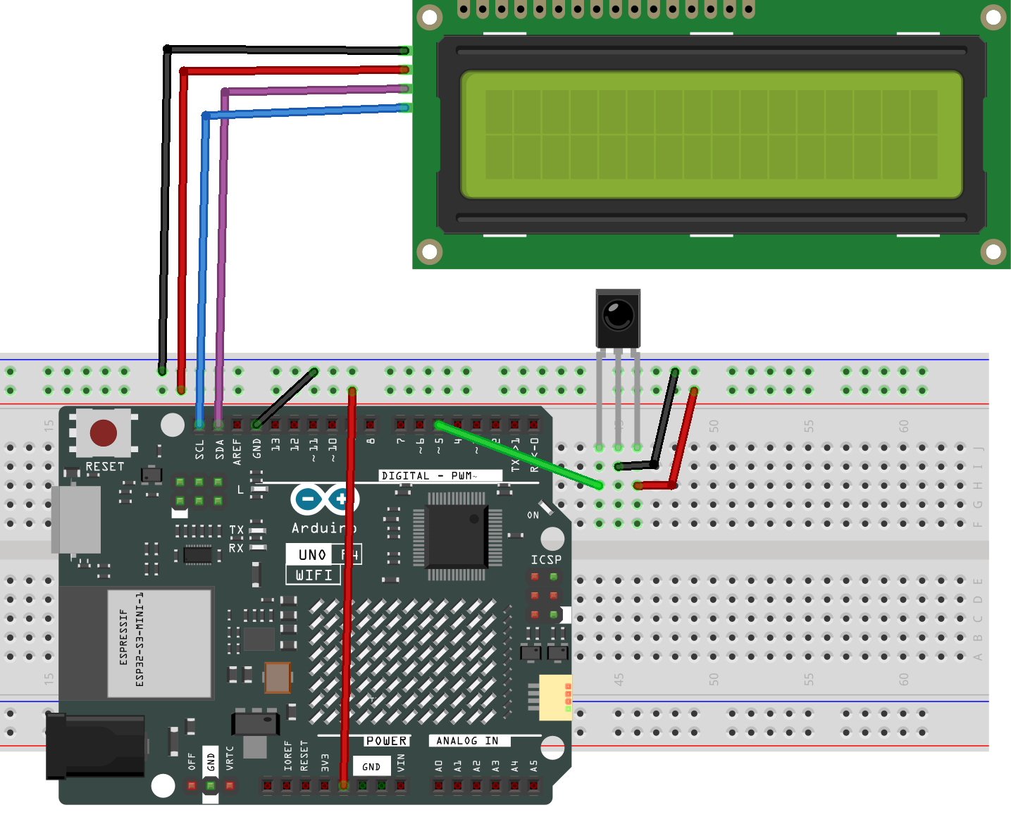

配線図
../_images/10_guess_number_bb.png
回路図
../_images/10_guess_number_schematic.png
