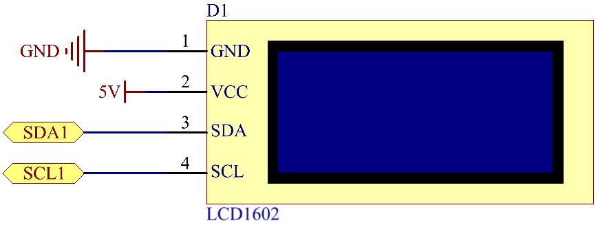

Schema Elettrico
T-Board Name
physical
SDA1
Pin 3
SCL1
Pin 5
../_images/1.1.7_i2c_lcd_schematic.png

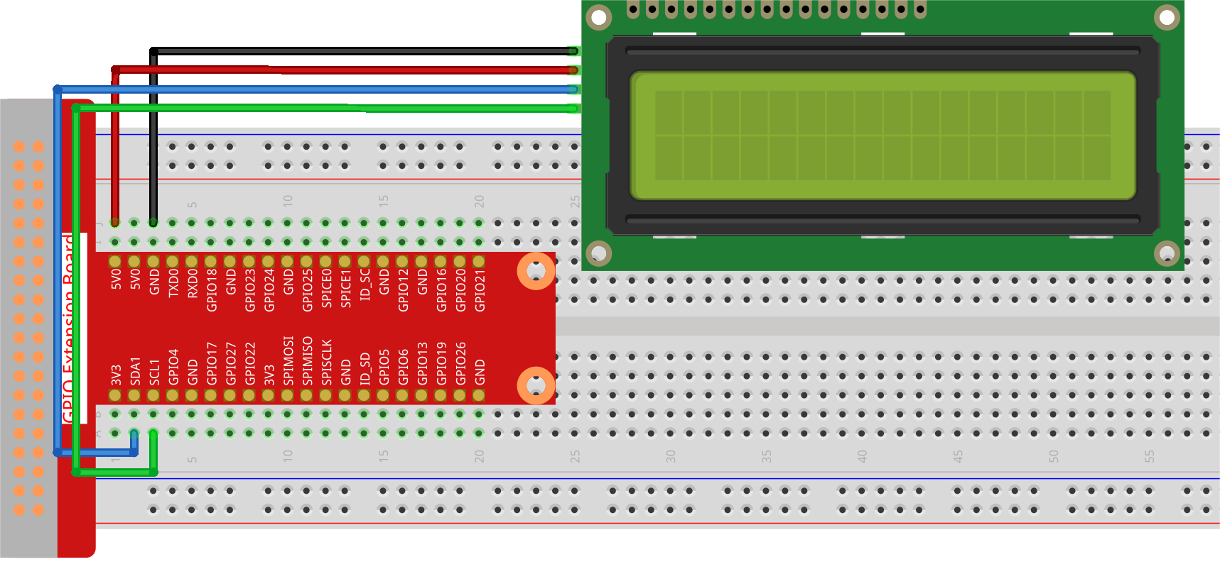

Passo 1: Assembla il circuito.
../_images/1.1.7_i2c_lcd1602_circuit.png
