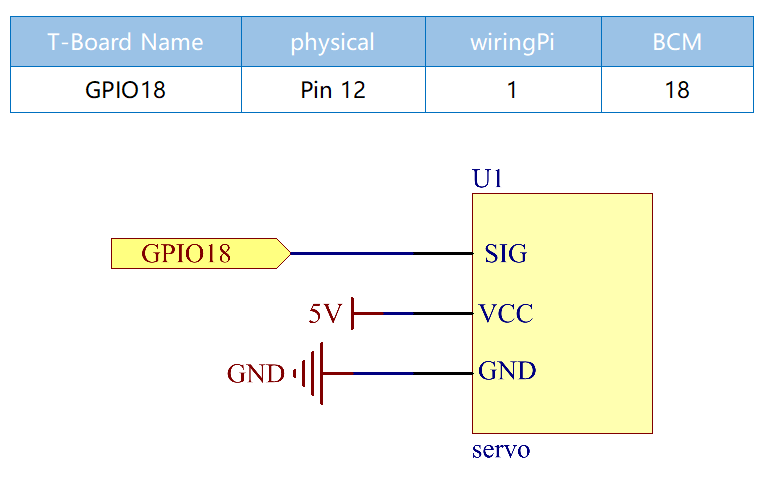

Schema Elettrico
../_images/image337.png

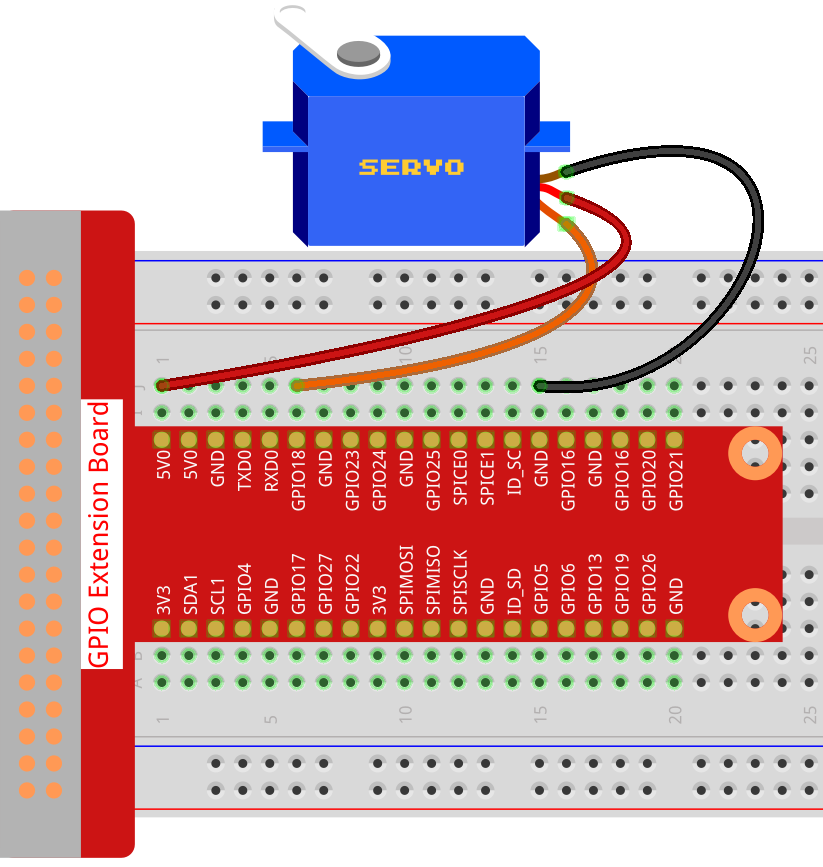

Procedure Sperimentali
../_images/image125.png
