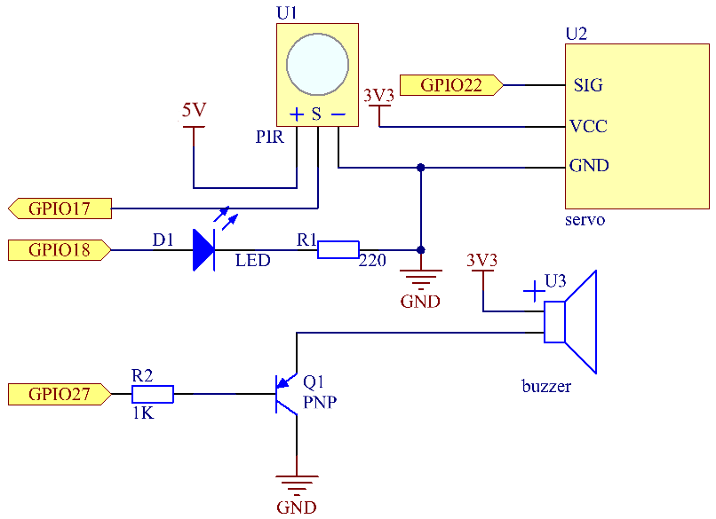

Schematische Darstellung
T-Board Name
physical
wiringPi
GPIO18
Pin 12
18
GPIO17
Pin 11
0
17
GPIO27
Pin 13
27
GPIO22
Pin 15
22
../_images/Schematic_three_one21.png
