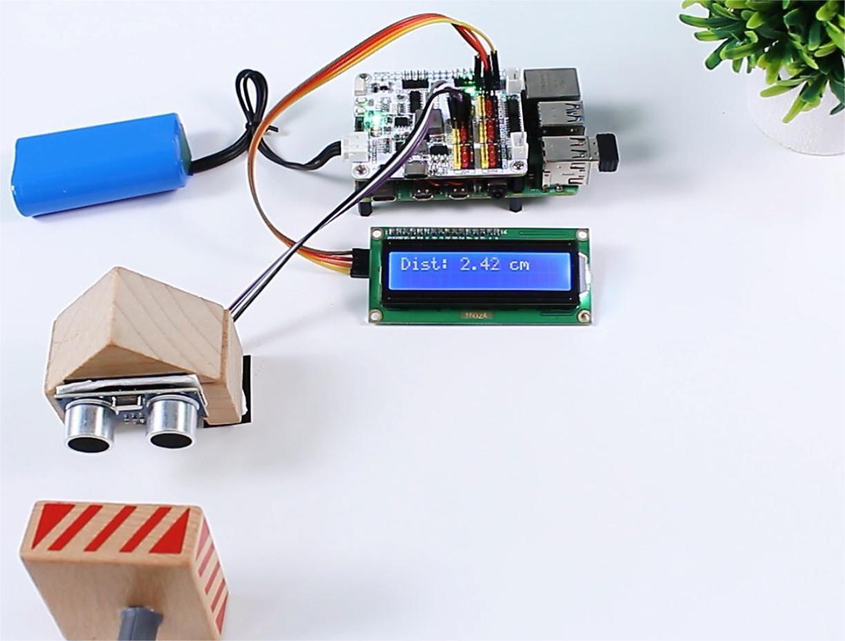

In this project, we use ultrasonic sensors to measure distance and display the readings on the I2C LCD1602.
_images/ultrasonic.jpg

  4. Use the command sudo python3 ultrasonic.ty to run this code.
