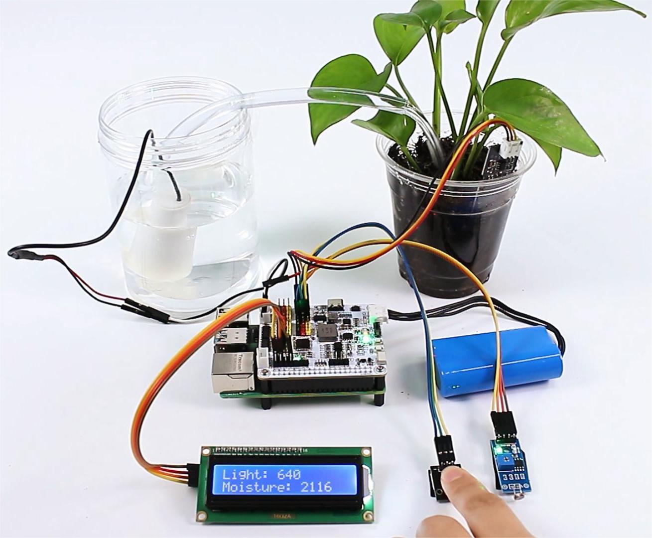

In this project, we detect both light intensity and soil moisture levels, and display them on the I2C LCD1602 . When you feel that the soil moisture is insufficient, you can press the button module to water the potted plant.

  4. Use the command sudo python3 plant_monitor.ty to run this code.
