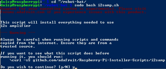

cd ~/robot-hat
sudo bash i2samp.sh
Type y and press enter to continue running the script.

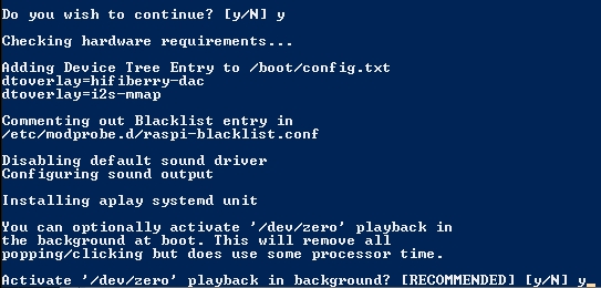

Type y and press enter to run /dev/zero in the background.
Type y and press enter to restart the Raspberry pi.
