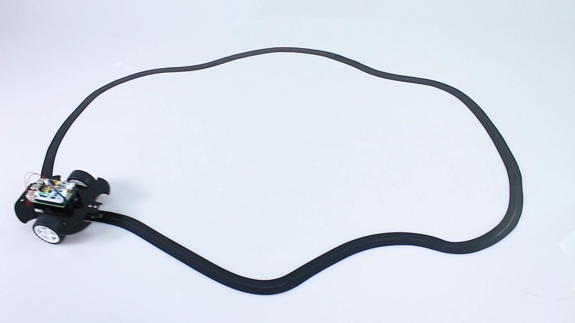

In addition to being suitable for simple experiments, the Robot HAT is ideal for use as a central controller in robotics, such as for smart cars.
In this project, we built a simple line-following car.
_images/diy_car.jpg
