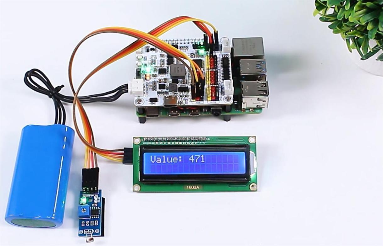

In this project, we detect the light intensity and display on the I2C LCD1602.
_images/photoresistor.jpg
