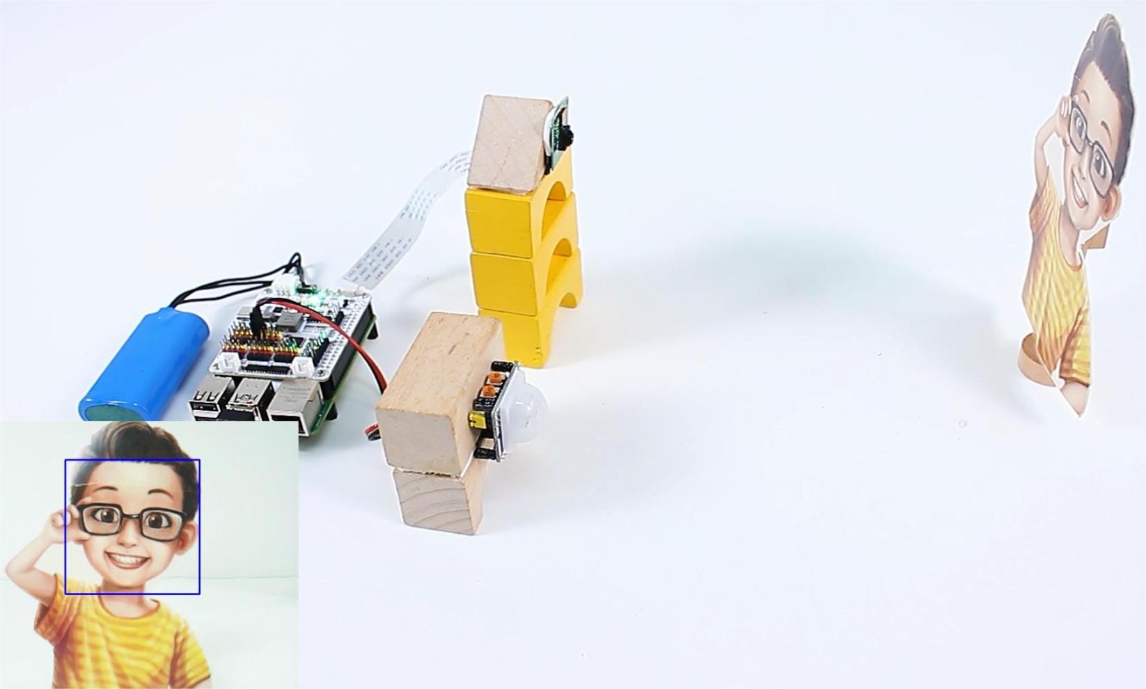

In this project, we’ve created a simple security system. The PIR sensor detects if someone passes by, and then the camera activates. If a face is detected, it takes a picture and simultaneously delivers a warning message.

  3. Use the command sudo python3 security.py to run this code.

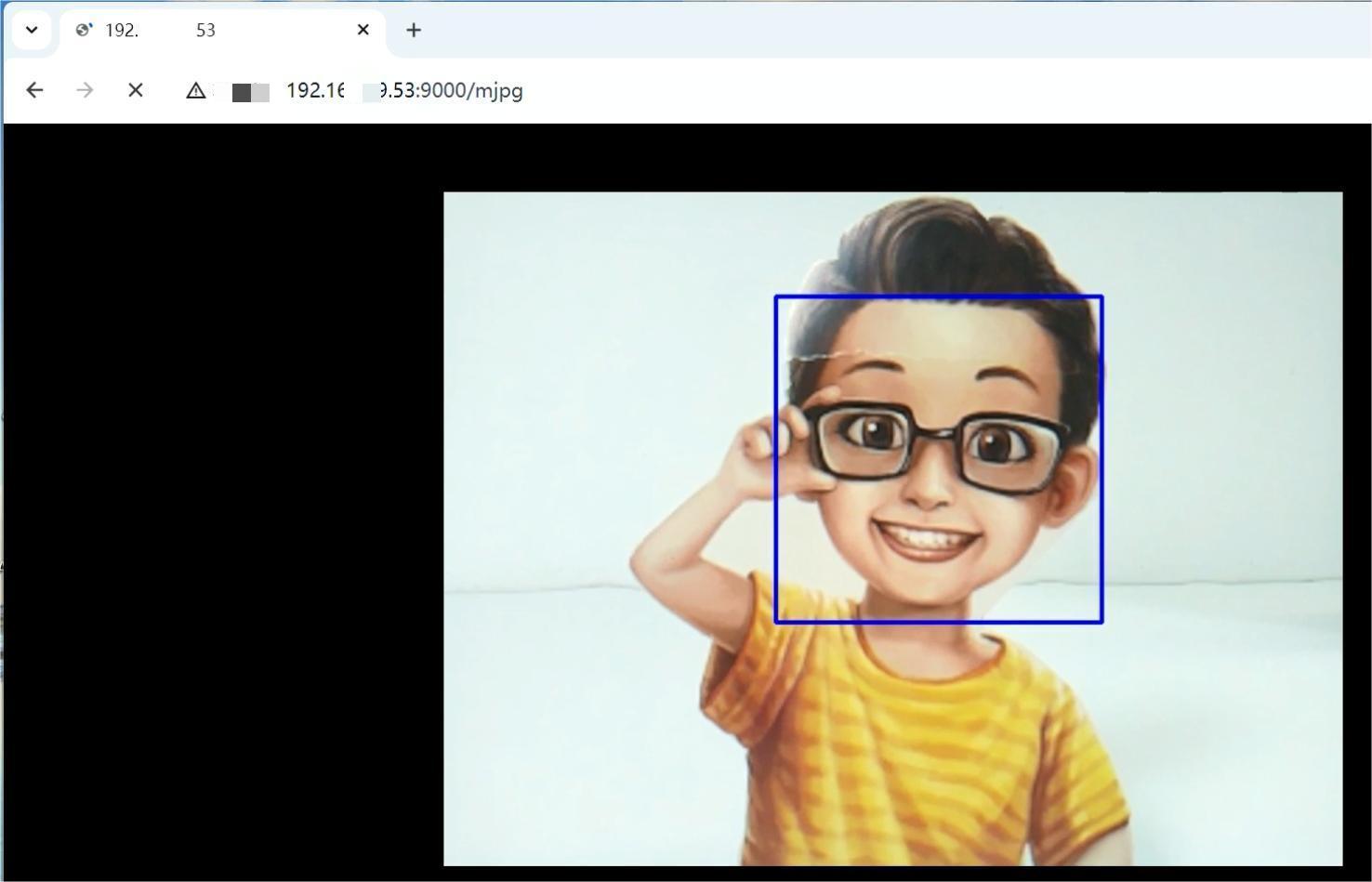

  4. Open a web browser and enter http://rpi_ip:9000/mjpg to view the captured footage. Additionally, you can find the captured face images in /home/{username}/Pictures/.
