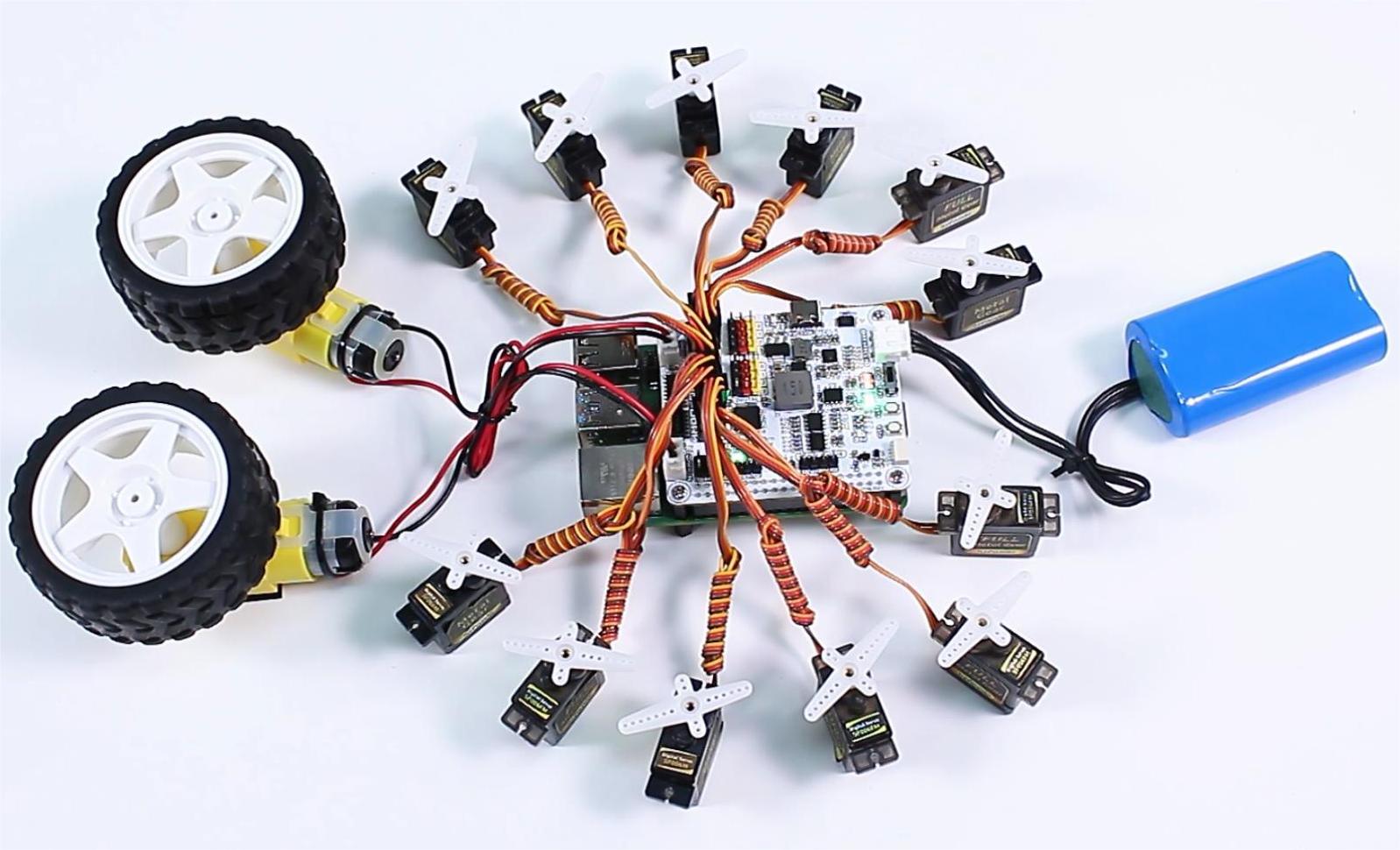

In this project, we have 12 servos and two motors working simultaneously.
_images/servo_motor.jpg
However, it’s important to note that if your servos and motors have a high starting current, it’s recommended to start them separately to avoid insufficient power supply current, which could lead to the Raspberry Pi restarting.
