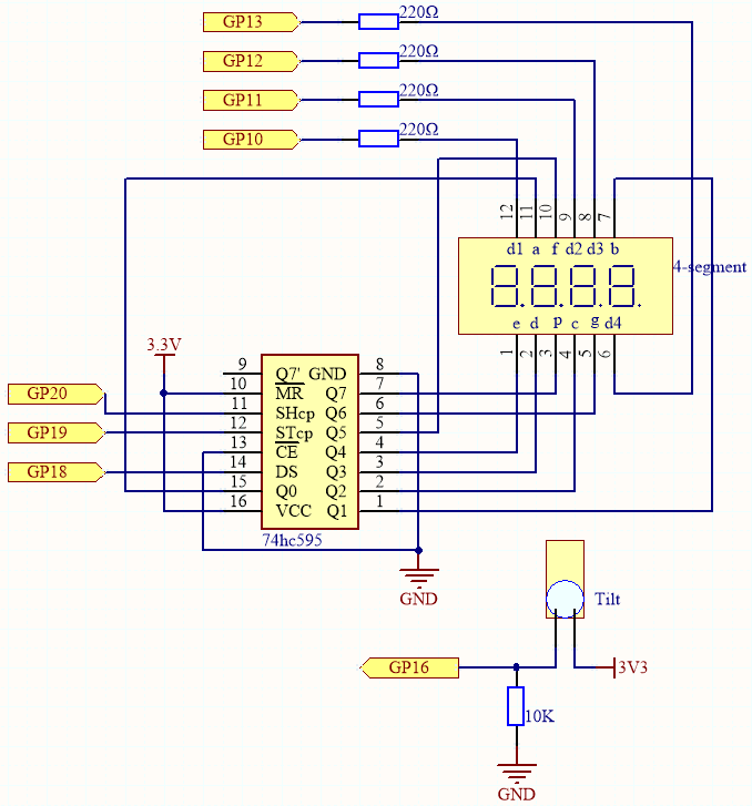

Schematic
sch_10_second
  • This circuit is based on 5.3 Time Counter with the addition of a tilt switch.
  • GP16 is high when the tilt switch is upright; low when tilted.
