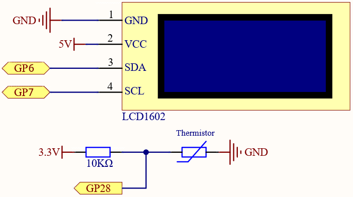

  • Thermistor: A type of resistor whose resistance varies significantly with temperature. We’ll use a Negative Temperature Coefficient (NTC) thermistor, meaning its resistance decreases as temperature increases.
  • Voltage Divider: By combining the thermistor with a fixed resistor, we create a voltage divider circuit, allowing us to measure changes in voltage corresponding to temperature changes.
  • I2C LCD1602 Display: A 16x2 character LCD display with an I2C interface, which simplifies wiring and code by using only two data lines (SDA and SCL).
Schematic
sch_room_temp

Troubleshooting
  • LCD Not Displaying Text:
    • Verify SDA and SCL connections (GP6 and GP7).
    • Check that the LCD is powered correctly.
    • Adjust the contrast potentiometer on the LCD module.
  • Incorrect Temperature Readings:
    • Ensure the thermistor and resistor are connected properly.
    • Double-check the resistor values.
    • Confirm that the BETA value matches your thermistor’s specifications.
