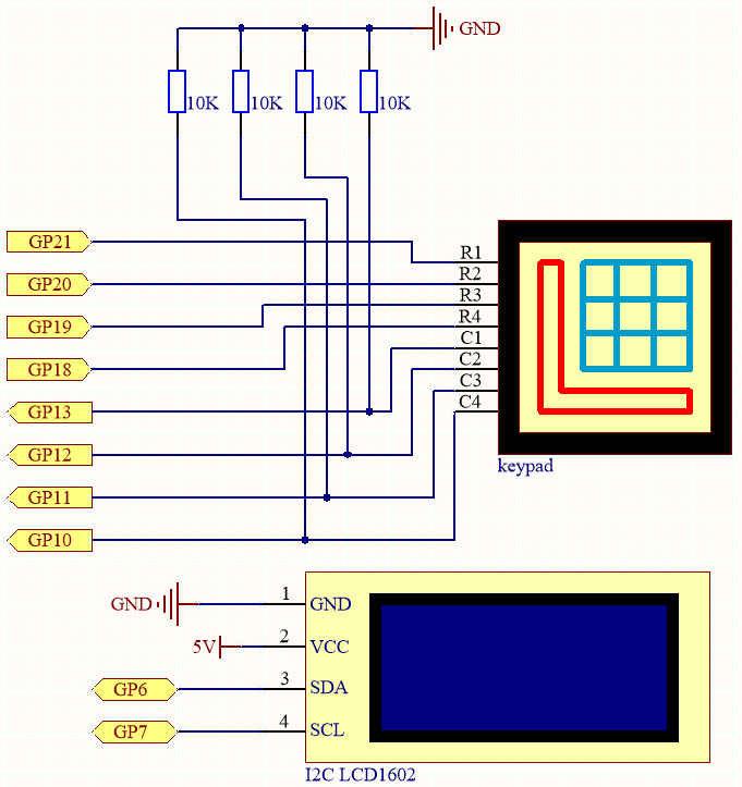

Schematic
sch_guess_number
This circuit is based on 4.2 4x4 Keypad with the addition of an I2C LCD1602 to display the pressed keys.
Wiring
wiring_game_guess_number
To make the wiring easier, in the above diagram, the column row of the matrix keyboard and the 10K resistors are inserted into the holes where G10 ~ G13 are located at the same time.
