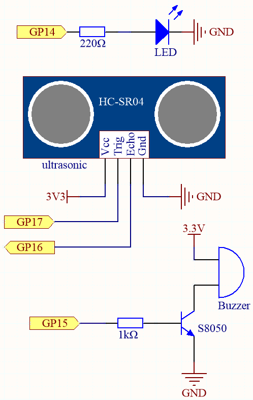

Schematic
sch_reversing_aid
Wiring
wiring_reversing_aid

Once the code is running, place an object at varying distances from the ultrasonic sensor. Observe the changes in the beep frequency and LED blink rate. The console will display the measured distance.
