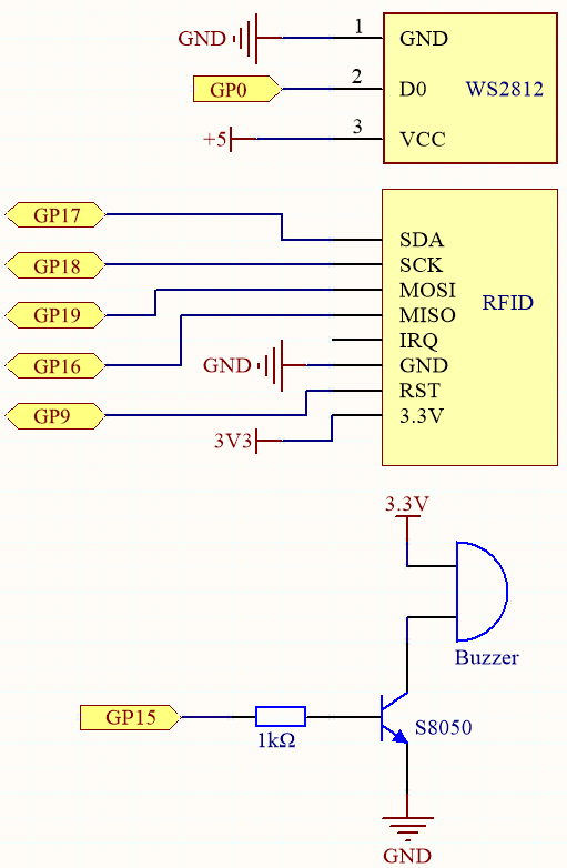

Schematic
sch_music_player
Wiring
wiring_rfid_music_player
