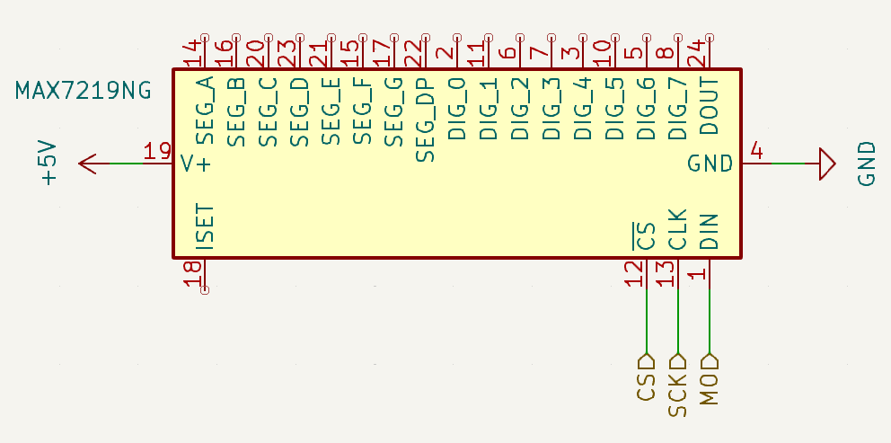

Circuit Diagram
The circuit connects the LED dot matrix to the Raspberry Pi using SPI communication. The schematic below provides a clear view of the wiring.
../_images/1.1.6_sch.png

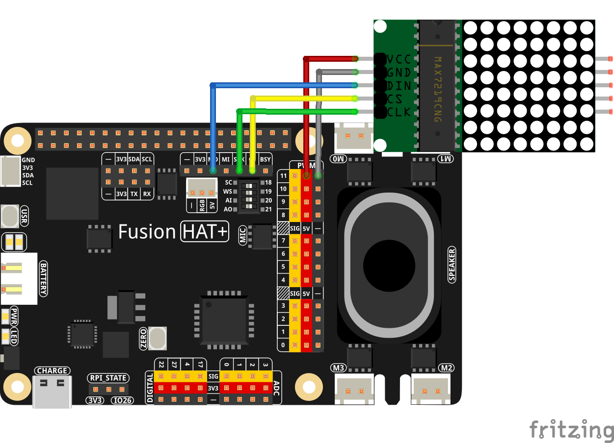

Wiring Diagram
Follow these steps to build the circuit:
  1. Connect the SPI interface pins (MOSI, SCK, and CS) to the Fusion HAT pins.
  2. Ensure proper power supply connections to the matrix.
../_images/1.1.6_bb.png
