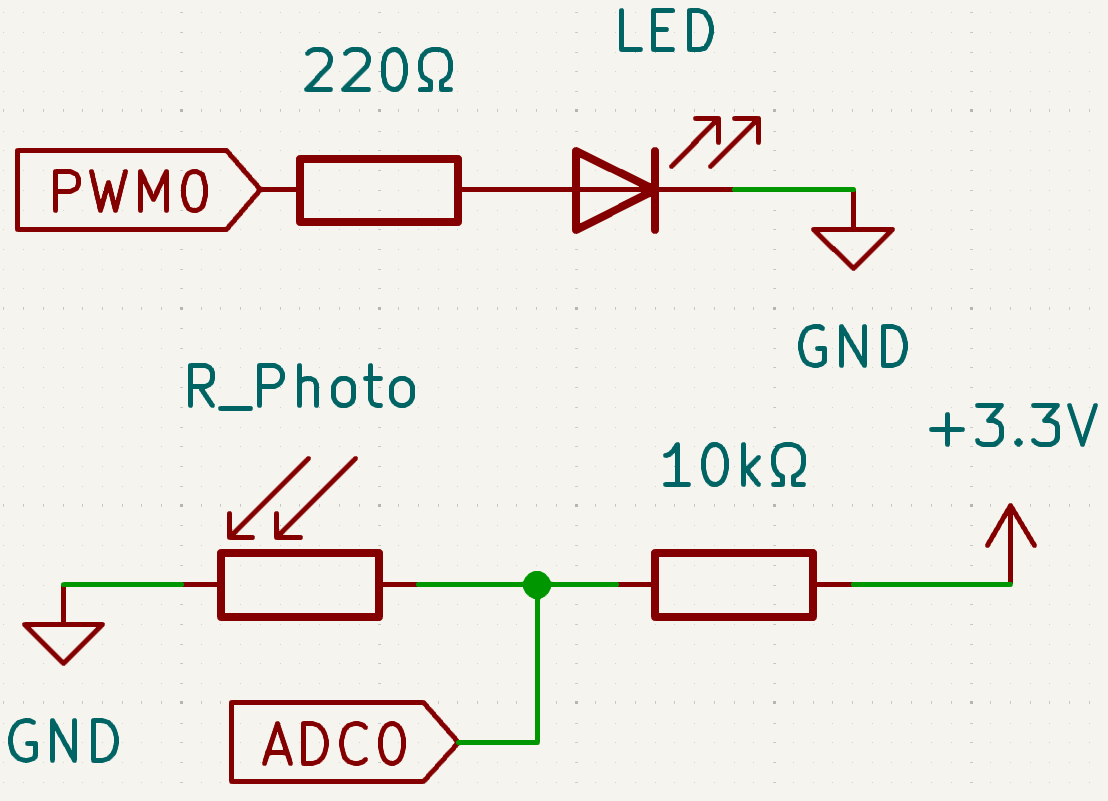

Circuit Diagram
Below are the schematic diagrams illustrating how to connect the components:
../_images/2.2.1_sch.png

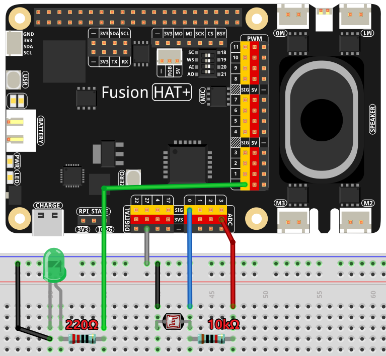

Wiring Diagram
Build the circuit as shown in the diagram below:
../_images/2.2.1_bb.png
Ensure that:
  • The photoresistor is connected to the Fusion HAT+ to convert analog signals into digital values.
  • The LED is connected to a GPIO pin for PWM control.
  • All connections are secure, and power and ground connections are properly set.
