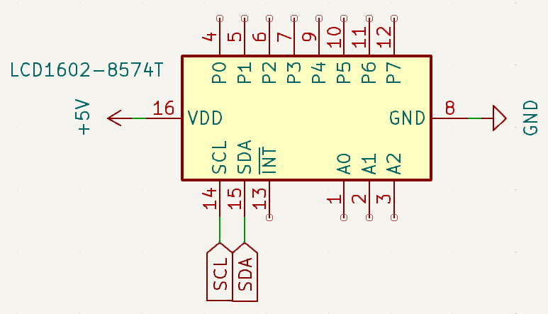

Circuit Diagram
The circuit diagram below shows how to connect the LCD1602 to the Raspberry Pi using the I2C interface.
../_images/1.1.7_sch.png
