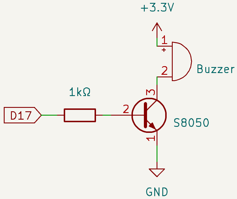

Circuit Diagram
The circuit uses an active buzzer, a NPN transistor, and a 1kΩ resistor. The resistor protects the transistor by limiting the base current. When GPIO17 outputs a high level (3.3V), the transistor conducts, allowing current to flow through the buzzer, causing it to beep. When GPIO17 outputs a low level, the transistor is cut off, and the buzzer remains silent.

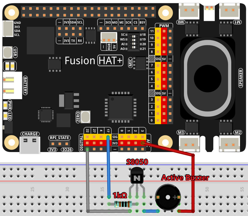

Wiring Diagram
Follow these steps to build the circuit:
  1. Place the NPN transistor, buzzer, and resistor on the breadboard.
  2. Connect the base of the transistor to GPIO17 through the resistor.
  3. Connect the emitter of the transistor to the power supply (+).
  4. Connect the collector of the transistor to one terminal of the buzzer.
  5. Connect the other terminal of the buzzer to the ground (-).
