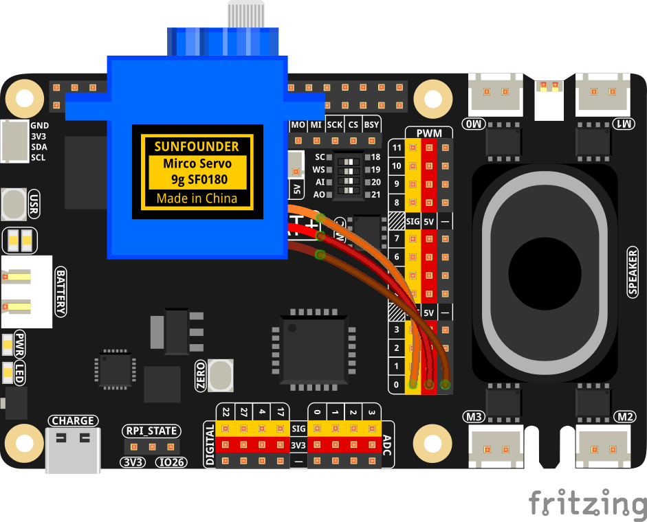

Wiring Diagram
../_images/1.3.2_bb.png

This Python script controls a servo motor connected to PWM 0. When executed:
  1. The servo moves from -90 degrees to 90 degrees in 10-degree increments.
  2. It pauses for 0.1 seconds between each movement.
  3. It then reverses the direction and moves from 90 degrees to -90 degrees in 10-degree increments.
  4. The process repeats indefinitely.
