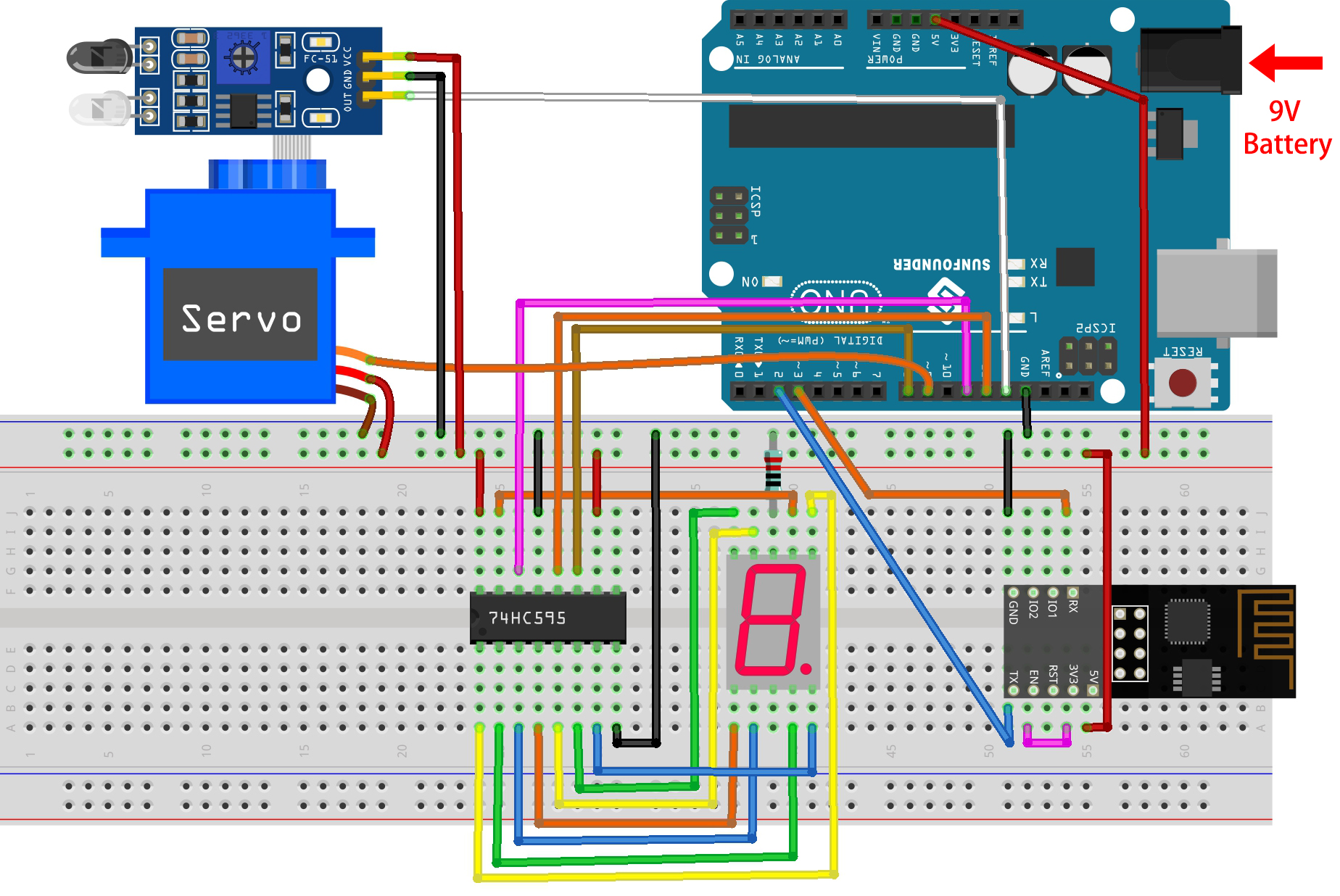

1. Build the Circuit
The ESP8266 module requires a high current to provide a stable operating environment, so make sure the 9V battery is plugged in.
../_images/wiring_servo_segment.jpg

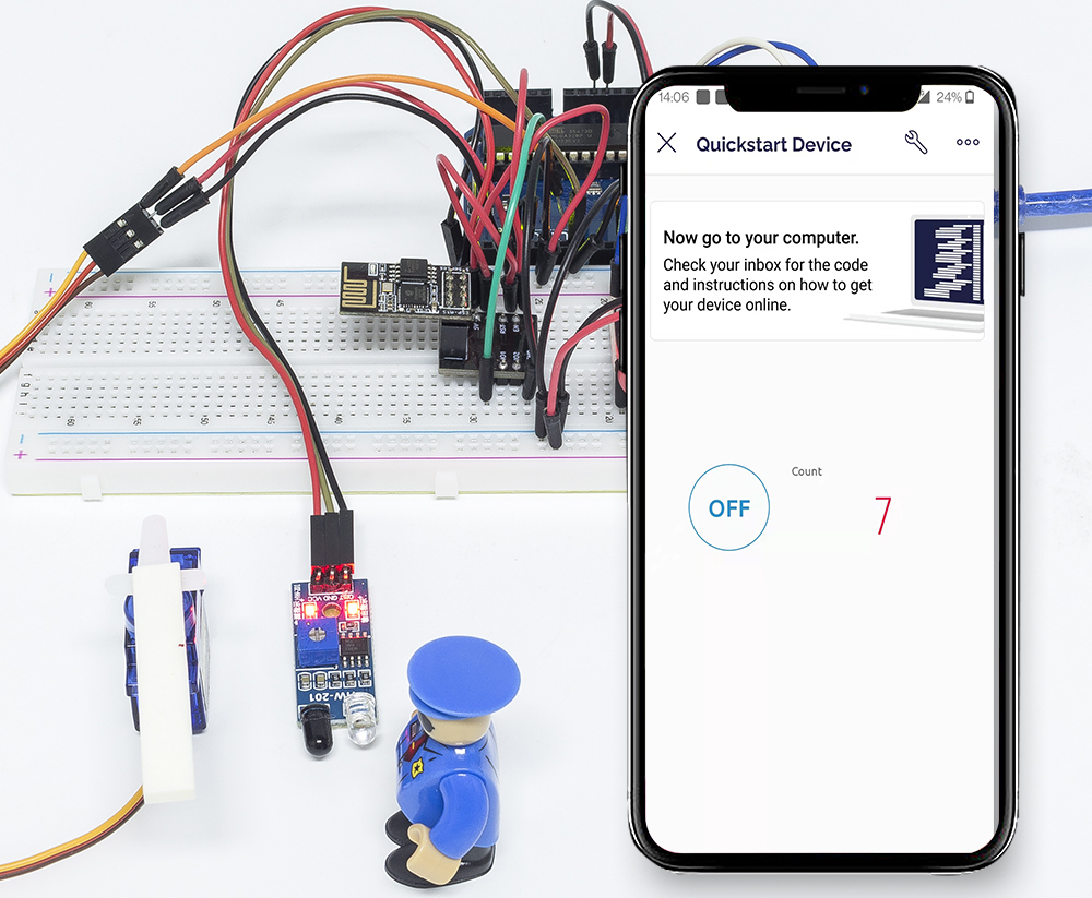

  5. Now click on the Button Control widget on Blynk to enable the smart door system. If the IR obstacle avoidance module detects an obstacle, the gate will open and the 7-segment display and the Count widget on Blynk will add 1.
    ../_images/sp220610_165548.png
  6. If you want to use Blynk on mobile devices, please refer to How to use Blynk on mobile device?.
    ../_images/mobile_gate.jpg
