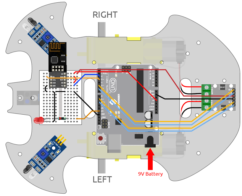

1. Build the Circuit
../_images/wiring_iot_car.png

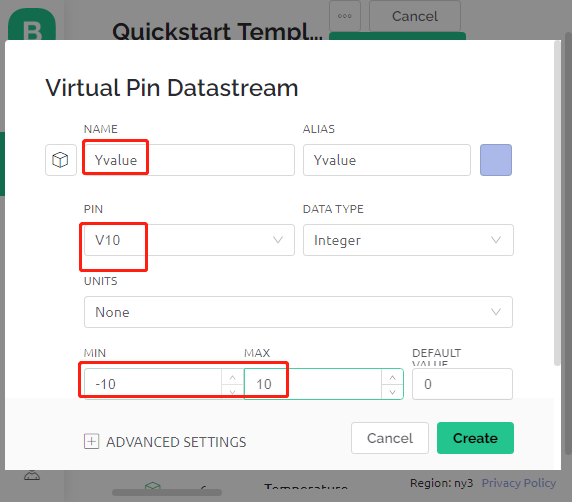

  1. Create a Datastream of type Virtual Pin on the Datastream page, to record the X-axis value of the joystick. Set NAME to Xvalue, DATA TYPE to Integer, and MIN and MAX to -10 and 10.
    ../_images/sp220613_164507.png
  2. Create a Datastream of type Virtual Pin to record the Y-axis value of the joystick. Set NAME to Yvalue, DATA TYPE to Integer, MIN and MAX to -10 and 10.

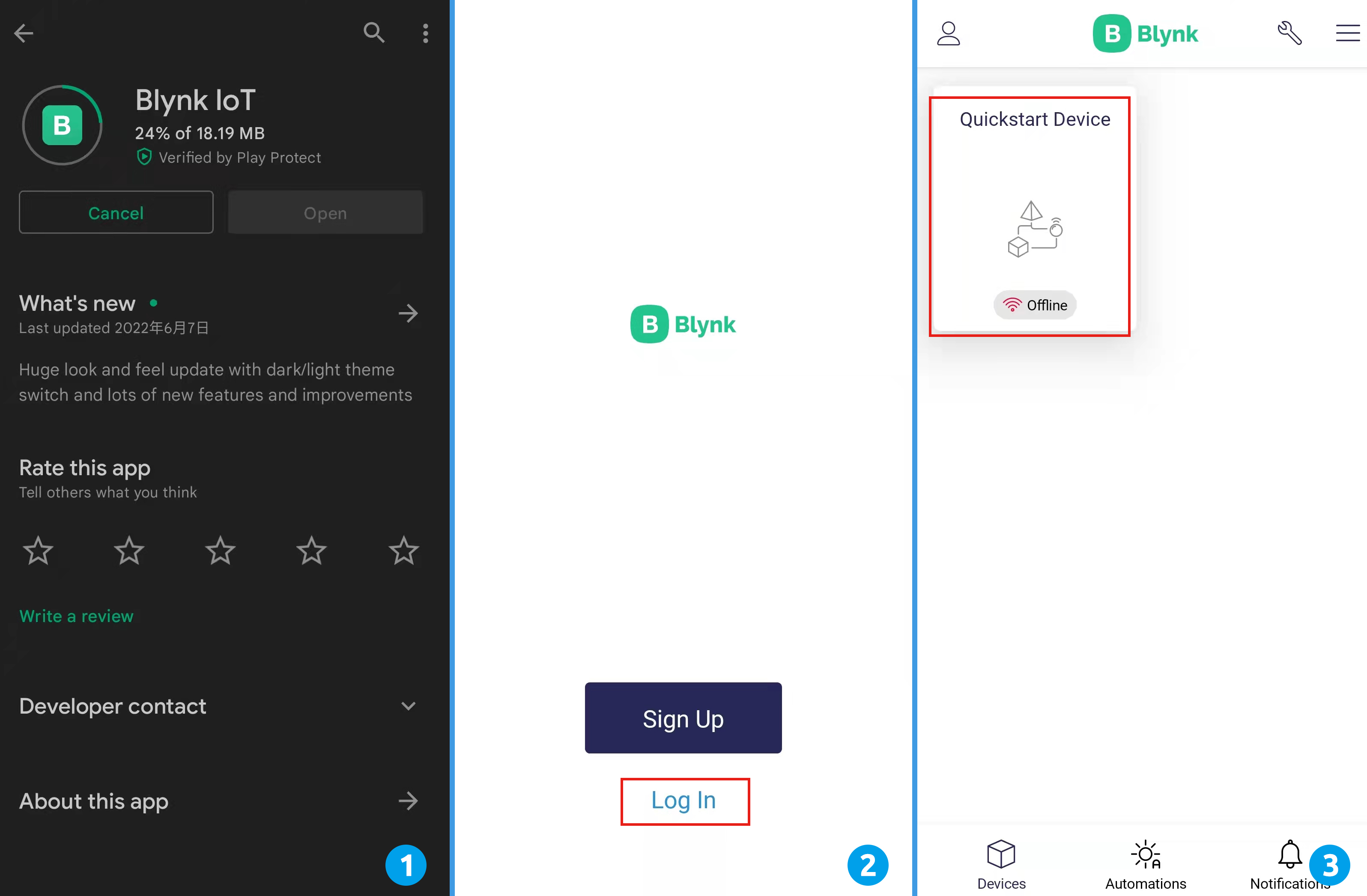

Next you need to do the following on your phone.
  1. Search for “Blynk IoT” (not Blynk(legacy)) in GOOGLE Play or APP Store to download it.
  2. After opening the APP, sign in, this account should be the same as the account used on the web client.
  3. Then go to Dashboard (if you don’t have one, create one) and you will see that the Dashboard for mobile and web are independent of each other.
