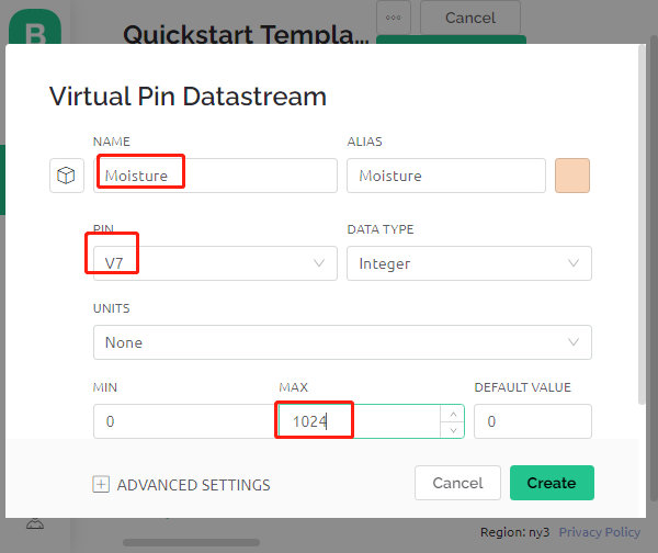

  2. For recording soil moisture, create another Datastream of type Virtual Pin on the Datastream page. Set DATA TYPE to Integer and MIN and MAX to 0 and 1024.

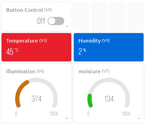

  3. Now go to the Wed Dashboard page, drag 2 Label widgets and set their data streams to V4 and V5 respectively; drag 2 Gauge widgets and set their data streams to show V6 and V7 respectively; and finally drag a Switch widget and set its data stream to V0.

  4. Back to the Blynk, you will see the current temperature, humidity, light intensity, and soil moisture. You can let the pump water the plants if necessary by clicking the Button Control widget.
    ../_images/sp220610_155350.png
