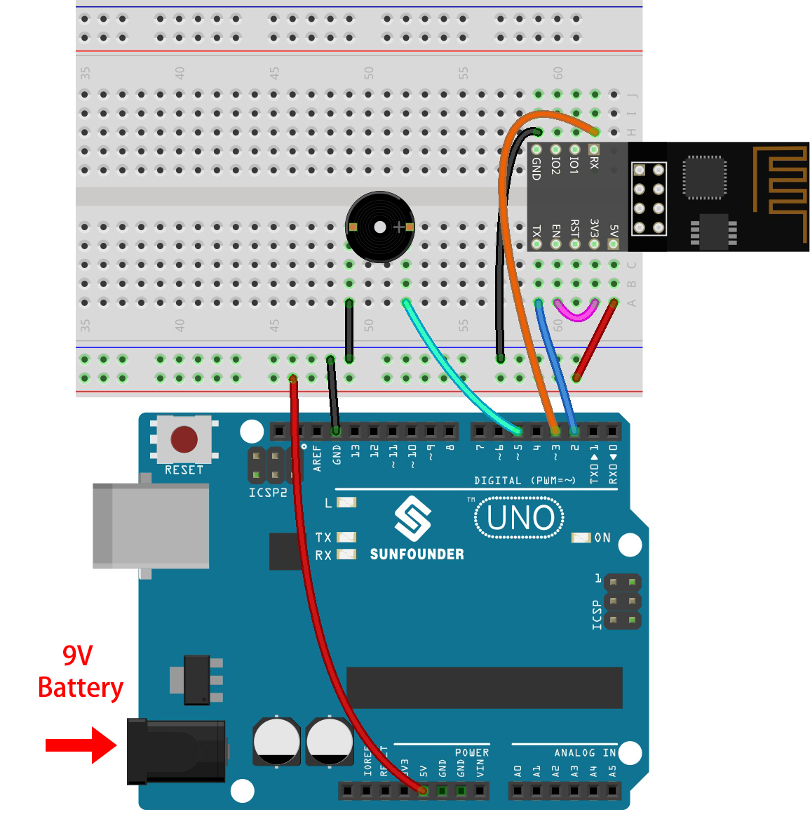

1. Build the Circuit
The ESP8266 module requires a high current to provide a stable operating environment, so make sure the 9V battery is plugged in.

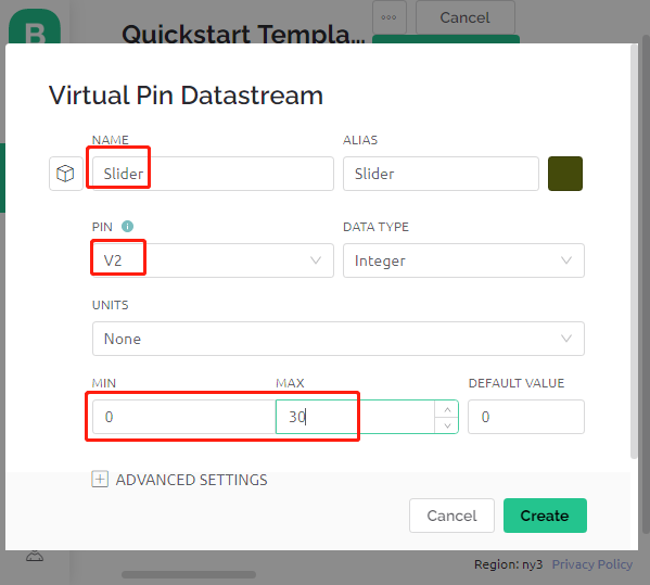

  1. Create a Datastream of type Virtual Pin on the Datastream page as the value modified by the Slider widget added later or code. Set the DATA TYPE to Integer and MIN and MAX to 0 and 30.

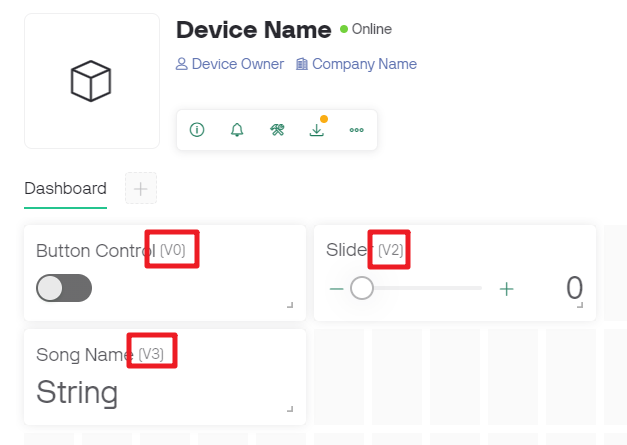

  3. Go to the Wed Dashboard page, drag a Switch widget and set Datastream to V0 (V0 is already set in 2. Get Data from Blynk); drag a Label widget and set it to V3; drag a Slider widget and set it to V2.
    ../_images/blynk_music_cloud.png
Your virtual pins may be different from mine, yours will prevail, but you need to modify the corresponding pin number in the code.

  5. Now, you can use Blynk’s Button Control widget to start/pause the music and the Slider to adjust the playback progress, and you’ll also see the name of the music.
