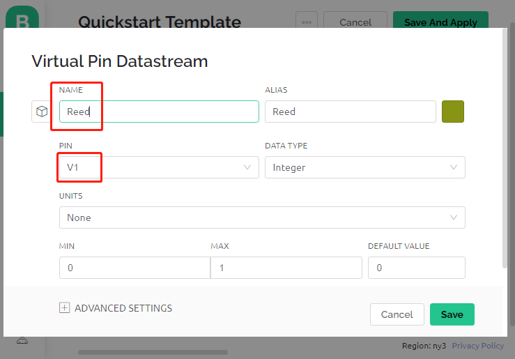

  1. Create a Datastream of type Virtual Pin in the Datastream page to get the value of Reed Switch. Set the DATA TYPE to Integer and MIN and MAX to 0 and 1.

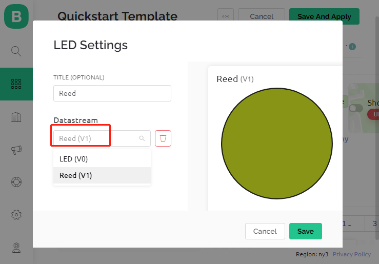

  3. In the settings page of the LED widget, select Datastream as Reed(V1), and save it.
