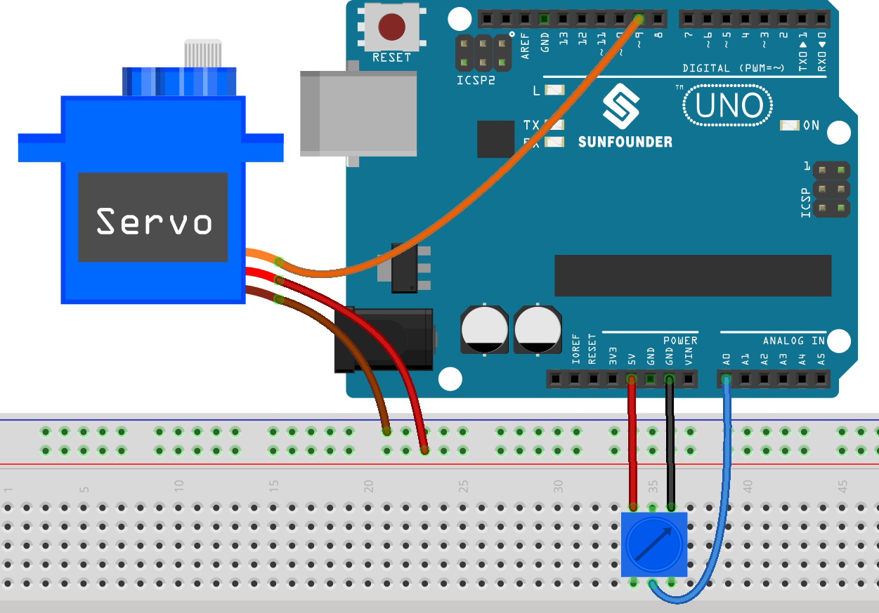

Wiring
../_images/map_bb.jpg
  • Open the 5.6.map.ino file under the path of 3in1-kit\basic_project\5.6.map.
  • Or upload the code through the Arduino Web Editor.
After the code is uploaded successfully, you can rotate the potentiometer back and forth, and the output shaft of the servo will rotate back and forth.
